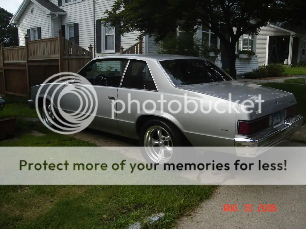

Here a pic of my old malibu with 17x7 front can't remember the tire size and 17x8 with a 275/40 rear.
