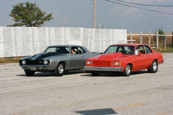

I have trick fronts and liked them but i had to raise my rear up to keep my tires from rubbing and now my car sits with the nose real low.I did cut my springs but i think after several years of driving on them they are starting to collapse and im gonna go to 6 cyl springs next just because they last longer on the street.In a car with good shocks like yours i dont think trick springs are necessary.
see how it sits so low now.It wasnt like that at first.This is after about 4 years of street driving though,and it got worse when i lifted the back up for tire clearance.
