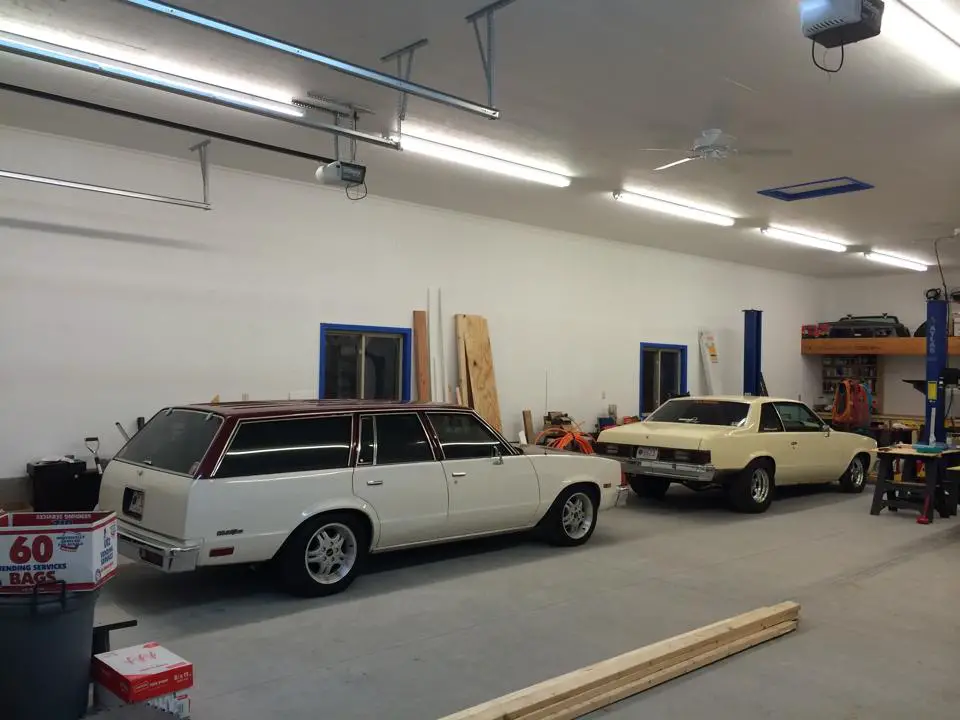

I have a set of Hotchkis springs on my 2-door, front is 600lb/in and rear is 150 or 160lb/in., sits like the current picture in my signature. It rides good for a street car, never really tried to push it since doing the frame-off, still sorting out noises & whatnot. The front springs would likely be about the same for you if you're just driving it on the street (strip cars use taller + lower rate springs to help with launch). The rears I can't comment on, never really looked into anything for a wagon. Misfit may have a little insight, his looks like it sits a little lower from the pics, street car.
