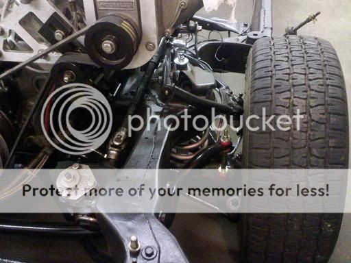

Can anybody spot anything wrong here? It pretty much went back together as it was before I took it apart. I had to slot the bolt holes in the frame brackets for the bar so was thinking that some other "mod" had to be done too (like different than stock length end links??). The suspension did not move when myself and a friend stood on the fram horns right before throwing the front clip on. He is 175 and I'm 185 lbs. The front control arms lower & upper were not fully tightened - so it is not like the bushings are holding the car up. I can only think that the massive size of the bar is able to lift the front of the car from the end links. I still have not tried removing the end links (just moved the car back to my house). I'll goof with them tonight.

You should not have had to slot the brackets, unless you tried to use the F body brackets (holes are offset). You need to reuse the G body frame brackets with the F body bushing.

Yes, I did use the F-body brackets.

with the engine in , your front suspension should have come down . Are the front springs a higher rate ? Are they installed (the springs) correctly ?
