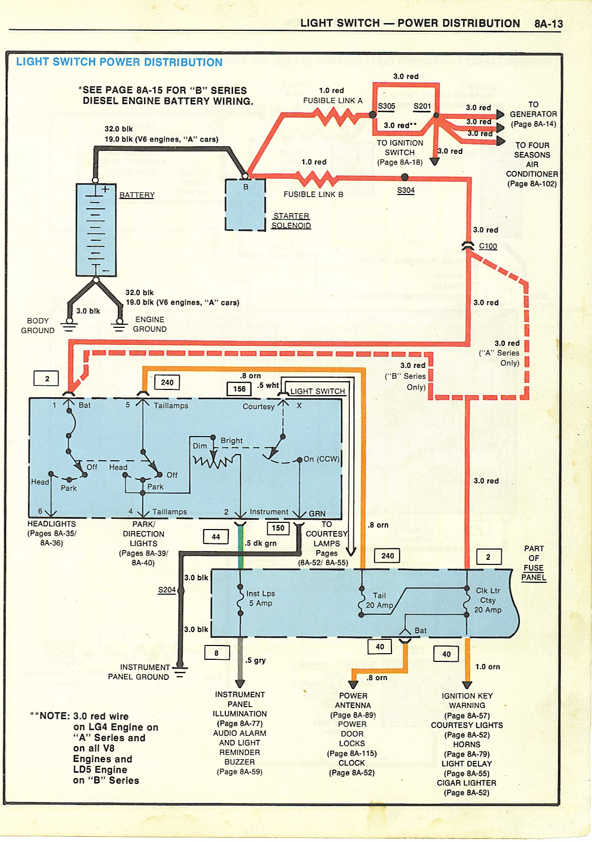

i got a super wierd problem ive replaced the headlight switch fuses checked all my grounds and still i have no parking lights or tail lights. i have headlights and brake lights no turn signals. i can take a wire and jumper from the main power source to the head light switch and get tail lights interior lights and buzzer all at once. If anyone has suggestions please let me know. if not where is the buzzer and ill just disconnet it for now so i can drive the ride at night.
