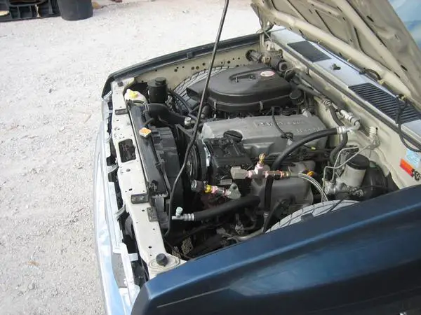

Heres a pic of that york I put in a nissan, it was a little 206 but it barley fit!
