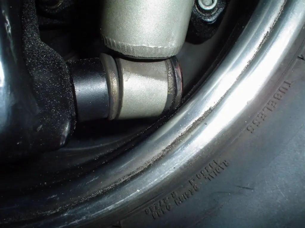

Im in the same boat as Cherp.Running 15x10 with 6 1/4 backspace.Im running a 325 and thats about the widest I can go.Right now theres just enough clearanceto where they slightly rub when theres people in the backseat.Cant say how a 6.5 inch bs wheel would clear the shock but heres a pic of mine.Its not as close as it looks in the pics,but yes its dam close.There is ways to move the shock mount though,so thats not that big of a deal.
