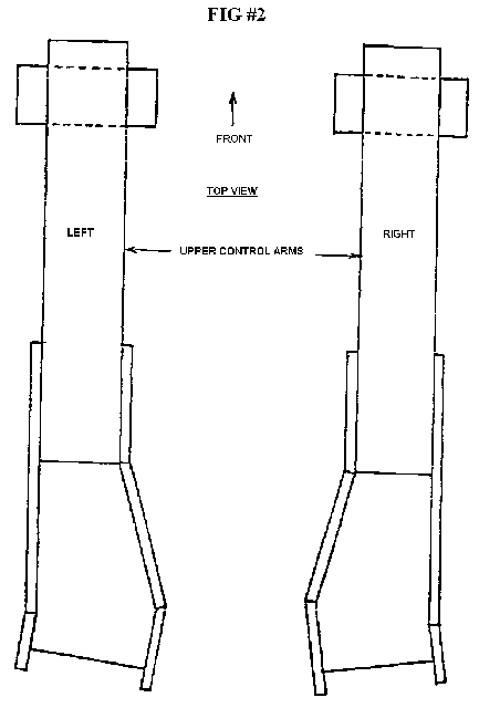

    5. Install the upper control arms into the chassis left and right as shown in Figure 2 using 12rnm x 90mm bolts, lock washers and nuts supplied with the kit.
