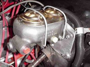

    How do I convert to manual brakes?
    Converting from power brakes to manual brakes is becoming a popular swap for A/G-Body car owners.  Especially if you are running a large cam, causing your engine to produce a weak vacuum and rendering  your power brakes virtually unusable.  There are plenty of aftermarket parts available, but the costs can become expensive rather quickly. What many do not realize is that manual brakes were available on A/G-Body cars. My ’79 Malibu came from the factory with manual brakes, so I simply bought new parts as I rebuilt the brake system. The only real change is the master cylinder, pedal pushrod, and a pedal pivot point relocation.
    A quick call to NAPA autoparts here locally confirmed that the manual & power master cylinders carry different part numbers. My local dealer did not stock the manual pieces, but could order them for me. The manual piece was $31.75 rebuilt, and $127.66 new.
    To make the conversion, the original power booster & cylinder needs to be unbolted from the firewall & discarded. A small aluminum plate should be fabricated to cover the large hole in the firewall where the booster previously mounted. 1/8″ thick aluminum should be fine as it is just a cover plate. The new manual master cylinder will slide onto the top two studs sticking out of the firewall. The brake pedal pushrod pivot pin is in the lower hole on a power car, and needs to be moved to the upper hole on a manual brake car. This higher hole allows for the proper pedal ratio and line pressure. I doubt anyone will be lucky enough to find a manual brake activation push rod, so a one will need to be fabricated from scratch.   This swap is quite simple to accomplish with little customizing and risking poor braking performance due to mismatched aftermarket parts. Using a rebuilt master cylinder can limit cash outlay to less than $75 for the conversion.
    BTW, many parts store master cylinders will not look anything like the factory piece. Mine was made by Bendix and included paperwork warning of the visual difference, but stated that performance was identical.
    By Todd Geisler
    For more information, go to the MANUAL BRAKE CONVERSION page
