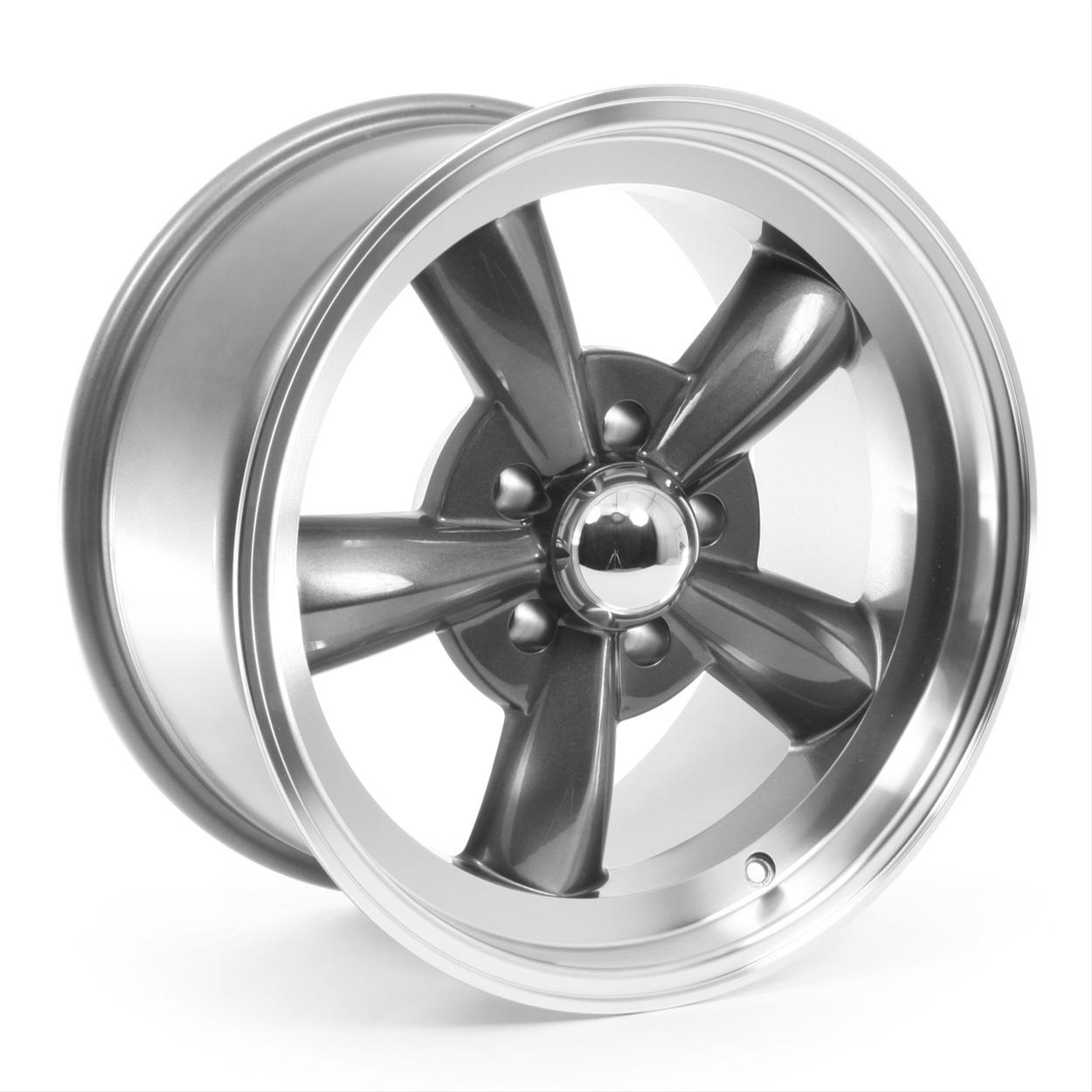

they fit they fit they fit!!!!!!! 275/40/70 maxxis tires) on craggar 17x9 5" BS BBC iron head 5608 moog virgin springs. and in no certain order.. only saw two problem areas the ont he forward part of the fender can earliy be trimed... as for the back... having inside mount weights they hit,,, going to be picking up some 1/4" spacers for the back

im running 245/60/15 and the rub on the, a arm, sway bar and catch the front fender part, rear side of the fender at full lock... the 275s did not hit any of it...i did a couple figure "8s" in my unlce's roughly plowed field plenty of 4-6" ruts with no rubbing... IIRC yours if lowered mine is not..
outside the front fender like there is min .5-1" clearance on the "pinch" points and plenty of clearance on the tire to inside fo the rolled lip at the top.
said tires i used..
JEGS Performance Auto Parts
with a UTQG 300 wear rating i dont expect to ger much more than 30k if that out of them... but at a 115.00 each it was hard to pass them up...
