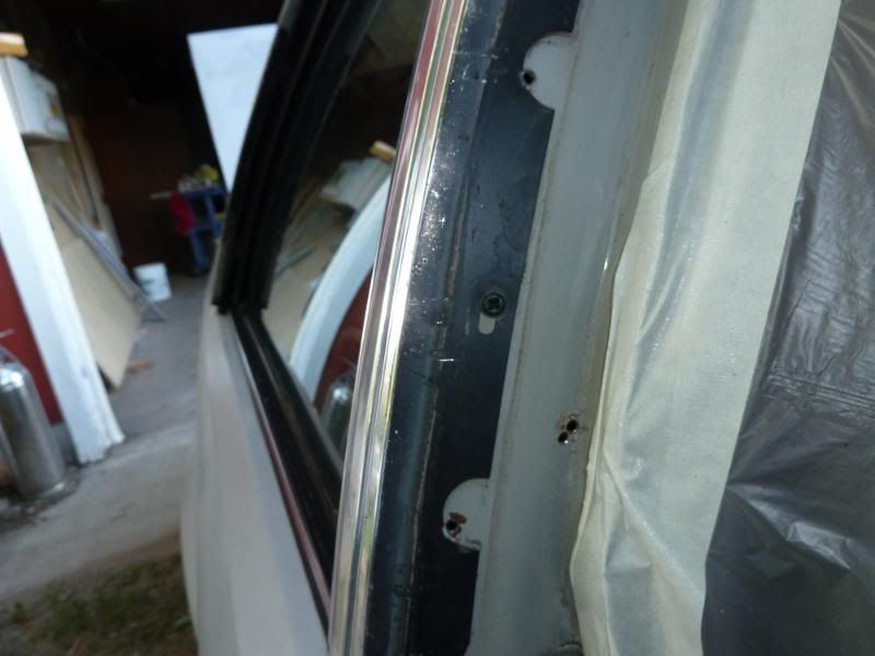

Can anyone post some photos of the trim and weatherstrip for the doors? When I got this car the weatherstrips were not installed. Someone also removed all the trim. If someone has some photos of this going together, that would be helpful. I'm trying to install the entire piece that is bent at the a-pillar as well as the quarter trim. Thank you!
EDIT:
Here's my main issue. I have the outer trim for the quarter glass but the weatherstrip needs something to hold it to the b-pillar. Here's a photo..
I need to know what the trim piece that goes here looks like. :-k

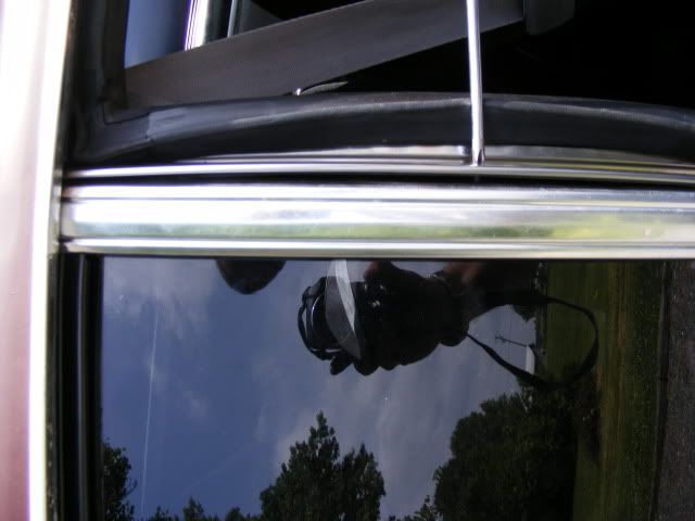

hey, don't know if you ever figured out your trim or not. but, on mine the trim doesn't hold the weatherstrip. it is just a separate piece of trim that is right next to the weather strip. took some pic's hope they help.

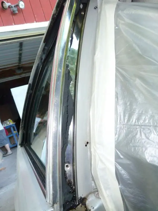

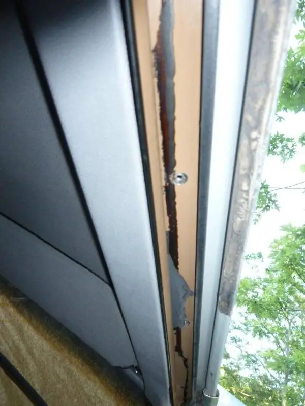

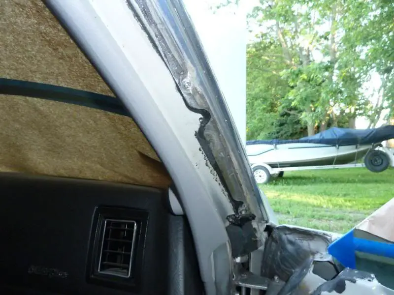

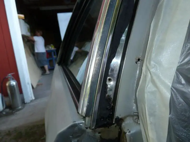

Shoot. I lost a few pics that i took to explain how it goes together. Here is how it goes together.
#1 no pic. Its the plastic Piece that goes in the 1/4 window. This goes in first
#2 is the one above
#3 is the chrome part that goes on the front edge of the front windows
This one can be #4 or 5. It doesn't matter. It is the one that goes next to your headliner.
This is the one you were missing. I had a pic of it cleaned up off the car, but it's gone. Here is another pic:
It can be put on as #4 or 5.
Hope this helps. Make sure to put some sealer between the edge of 4 & 5, as there will be a little gap there that your weather stripping won't cover.
