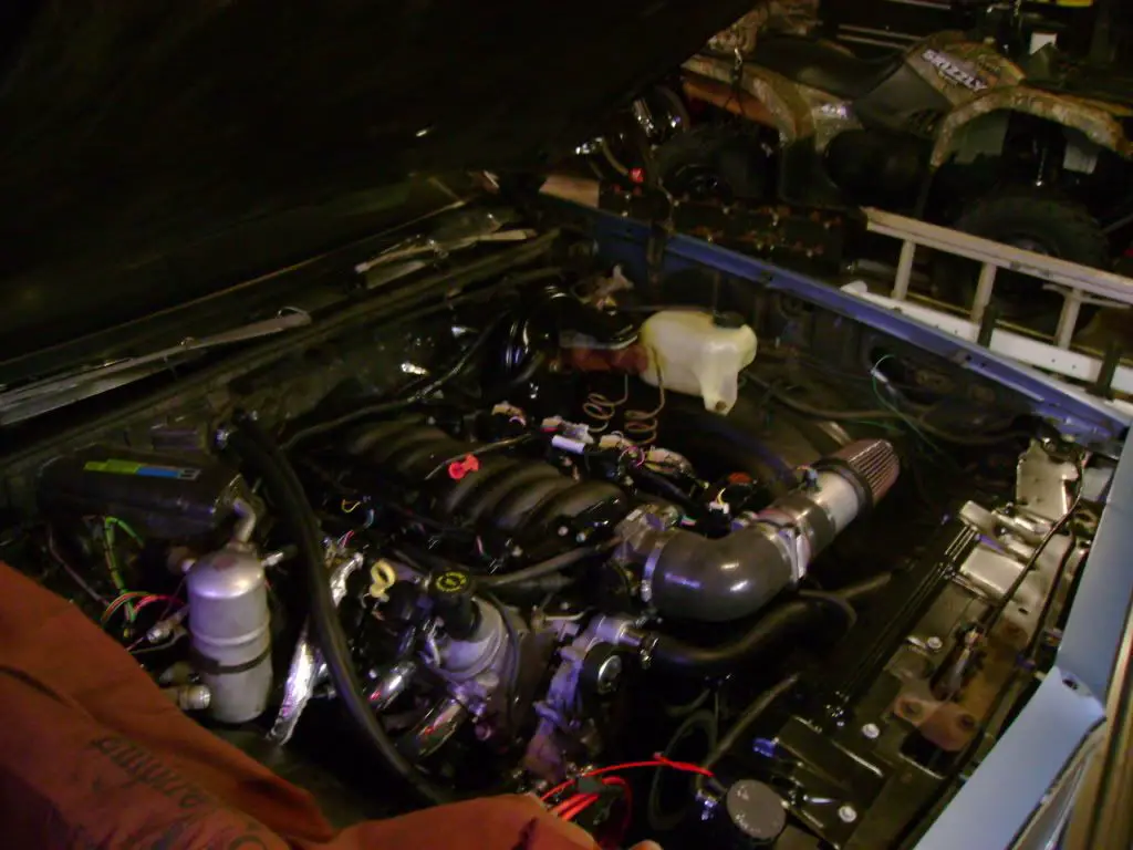

-got the Power Steering squared away: i used a 2000 camaro pressure hose - i ended up rotating the end that goes to the box and tweaked it a little and it fits good. for the return i used the stock malibu fitting with a new piece of hose.
-cooling system: i used an F-body radiator, the upper and lower camaro hoses work fine (i trimmed @ 1in off the radiator side of the lower hose) and some 3/4 and 5/8's heater hose.

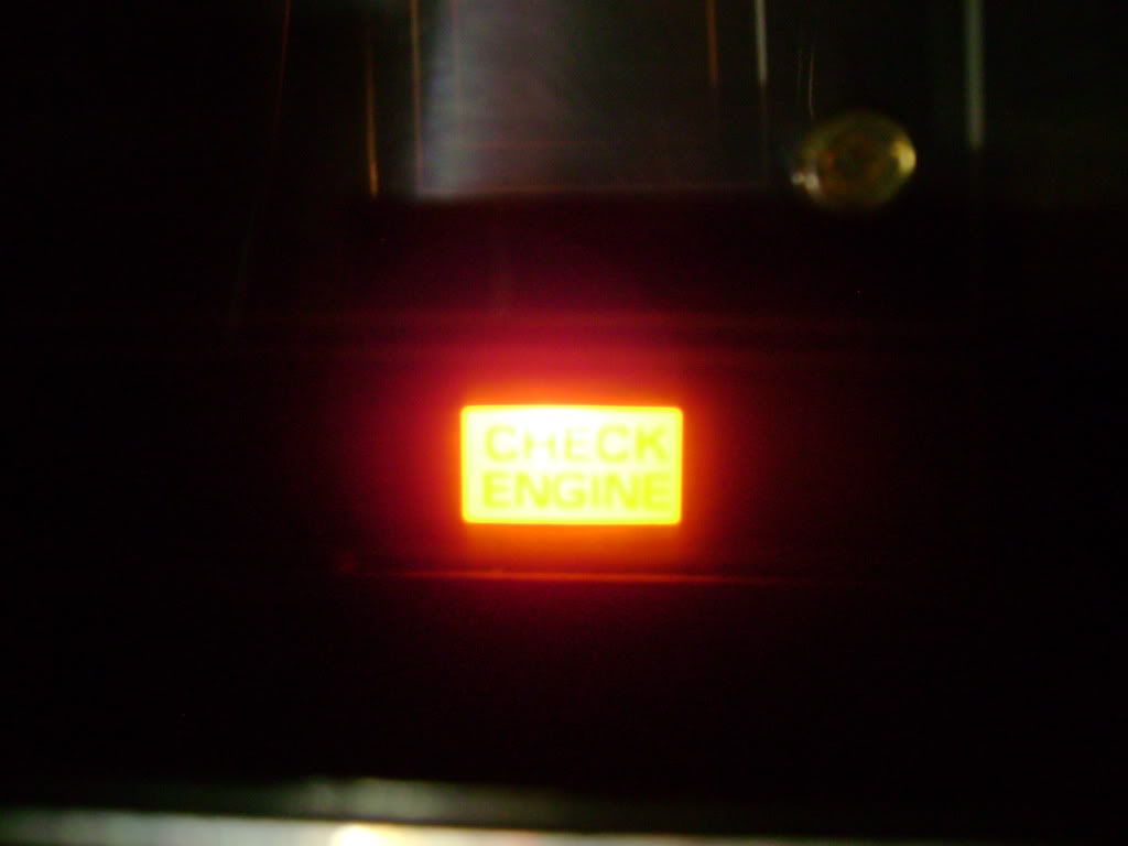

-wiring: i tied up most of the loose ends, hooked up the MIL(luckily the 80 and later 'Bu has a provision for a check engine light so it looks factory). i plan to move the battery to the trunk and mount the switch when i get the car back from having the exhaust welded up. i also need to wire up the cooling fans, the line lock, and the cable-x box

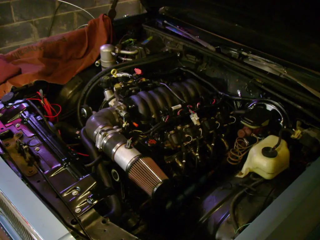

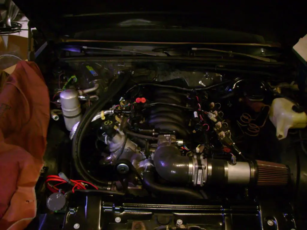

all in all it was a long weekend but the car atleast looks like its made progress, here are a few pics:
engine compartment getting there

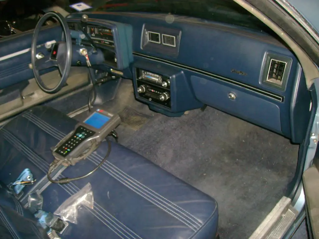

interior looks stock :D :D :D

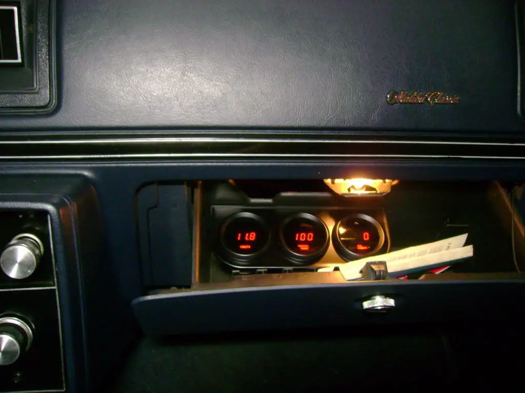

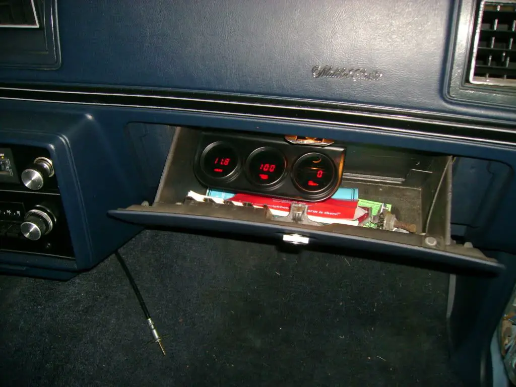

gauges in the glovebox

MIL light

computer will be in the engine compartment where the battery used to be

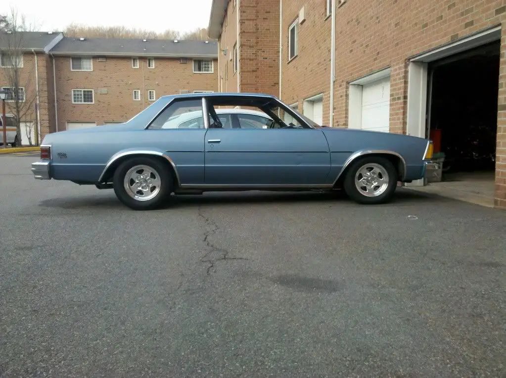

-installed a set of BellTech 2inch drop spindles and did an alignment
-bolted on a set of centerline telstars
and.... then i drove it home!!! :D :D :D
ive put about 40 miles on it so far, aside from the idle being kinda low(which my tuner will hopefully fix on the dyno in the next week or so) and the summit brand coolant temp gauge being like 30* off(my scanner will have to do for now) the car drives great! has great highway manners, runs pretty cool @ 185-195*
i still need to hook up the cable X box for the speedometer(my scan tool works great for that temporarily too lol) and wire up the line lock, but driving a fresh build for the first time never gets old.
i think the stance is perfect(maybe might get a set of 1inch drop springs for the rear after i get a set of 275 ET streets for the back) handles good for having the stock V6 suspension from 1980 (definately needs a rear sway bar)
ill post some pictures tomorrow when its light out of everything.
