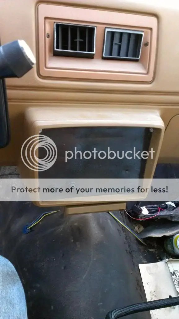

And some pictures of my home made AC block off plate, and radio delete plate (some old tin I found at my dad's). You'll notice a switch which acts as a keyed 12v, and a push button start. I had already taken out the engine harness and associated wiring, and I don't care if it has a radio or heat/air, so I'm good with that. Don't mind the wires, I'll have to pretty up after I get it going.

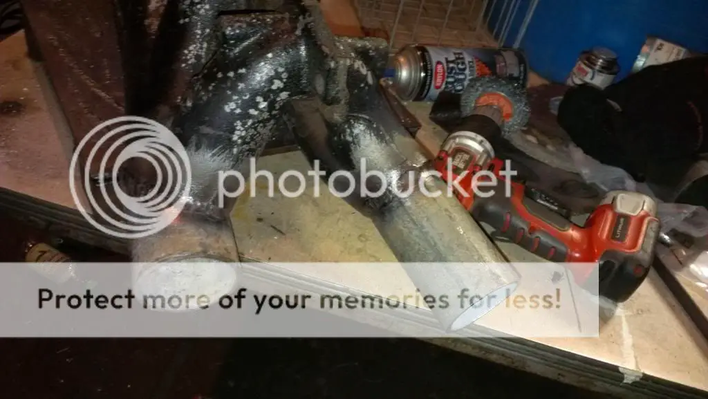

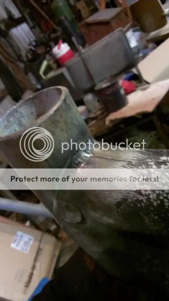

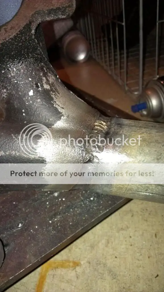

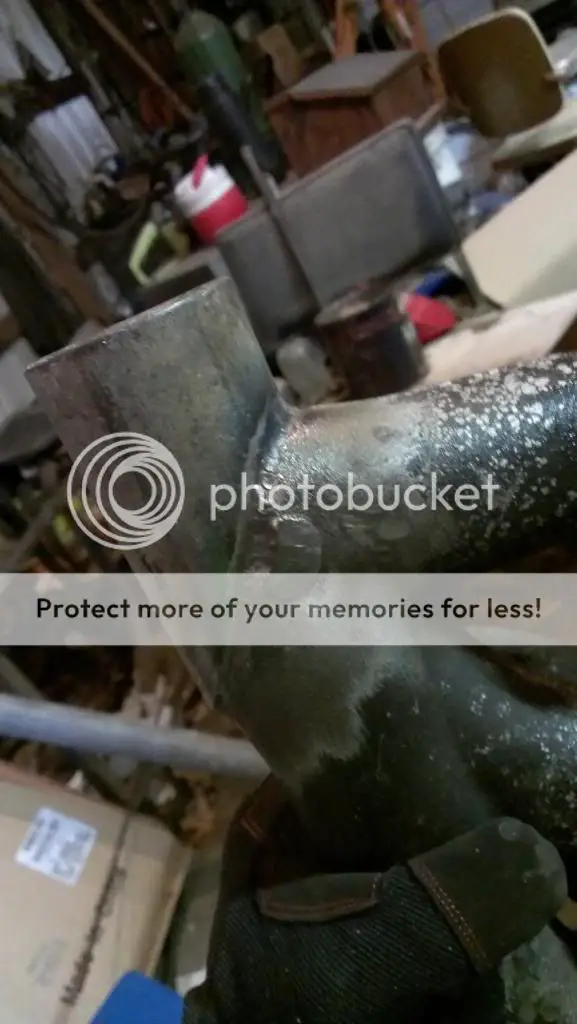

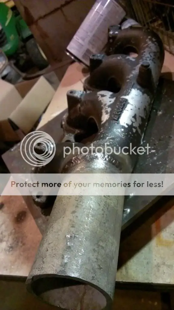

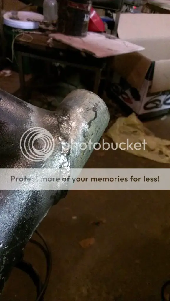

Decided I didn't like the up and forward manifolds, cut off the ends and welded on some pipe I found in the garage. I think it turned out ok. Manifolds weld pretty good. Clearance is pretty tight, but I think it's gonna work out. Driver side is barely touching the rag joint and the blue steering shaft cover has to go. Just going to have to make a couple cuts and rebend the pipe a touch. Next day I get off I'm putting a little more pipe on so I can put the o2 sensor in. So far I'm pretty impressed with the Holley EFI. Starts right up no questions asked after just a SMALL amount of fiddling. I still have a lot of work to do and a lot of cleaning to make it pretty.
Here's some pics of the manifolds, and a Video, everyone loves Videos.

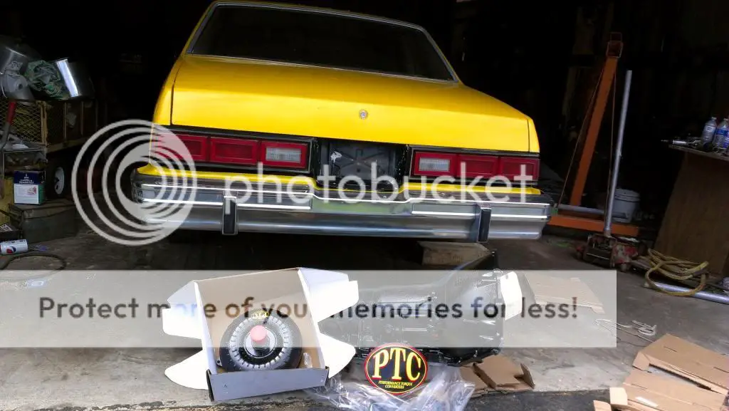

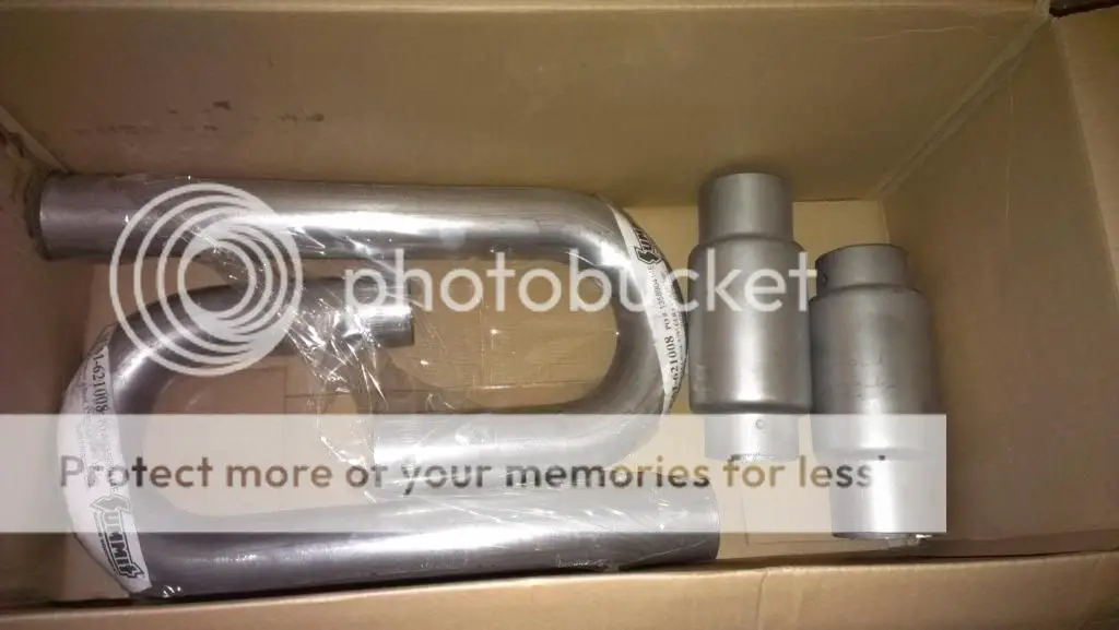

Got in some exhaust and my transmission and converter. Trans and converter are almost in, couple more bolts. Going to work on exhaust after I get the trans in where I want it.

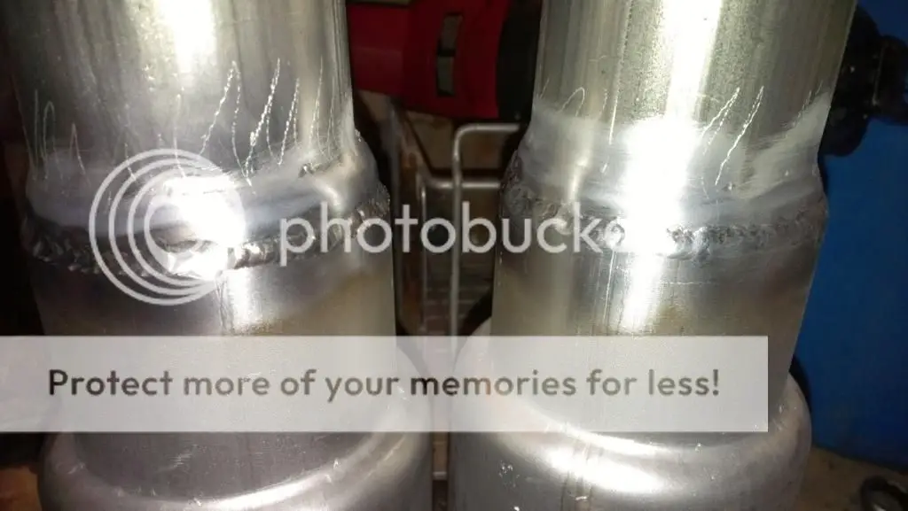

welded reducers on my bullets (3-2.5)

Everything I've read is don't run a solid mount, too much torque on the case and it often splits the bellhousing. Those are some pretty welds :D
