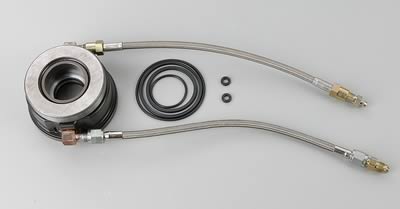

If you go to a hydraulic setup, I think you'll save yourself a lot of headache getting a hydraulic throwout bearing. It's self-containted and slips right over the input shaft (all sexual humor aside :p) so that makes things much easier. It will likely have a separate line coming out of it that will be used for bleeding the system.

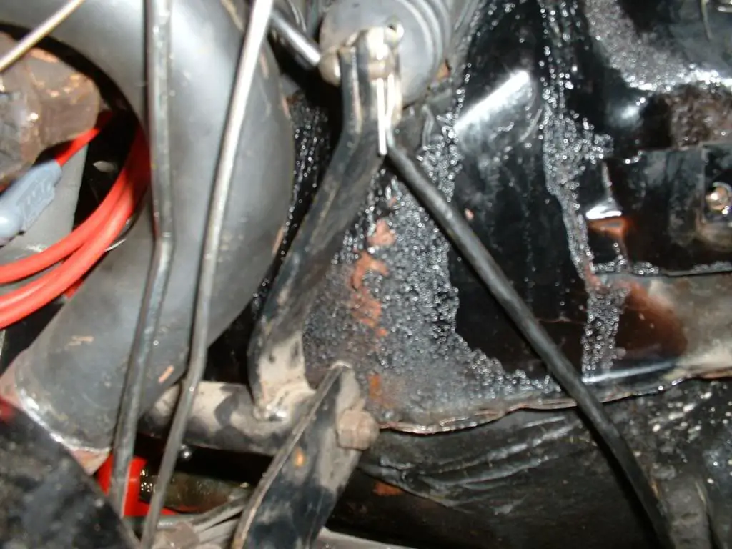

I've ran regular bellhousing or lakewood scattershield on my
car for 18 years. I also use a normal GM car clutch fork. I've had big blocks and small blocks. One tube has been changed on the Hooker 2241's and I had to dent the floor under the gas pedal for the clutch fork. To Me that's easier than finding all the Malibu clutch stuff.

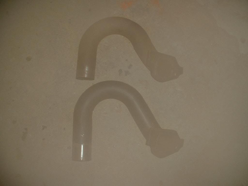

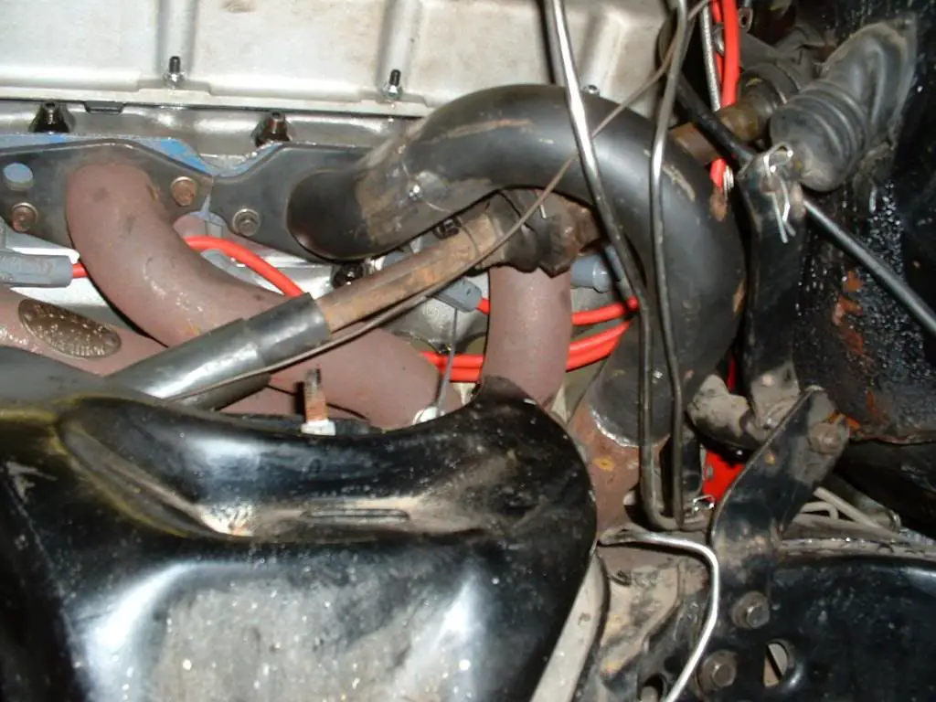

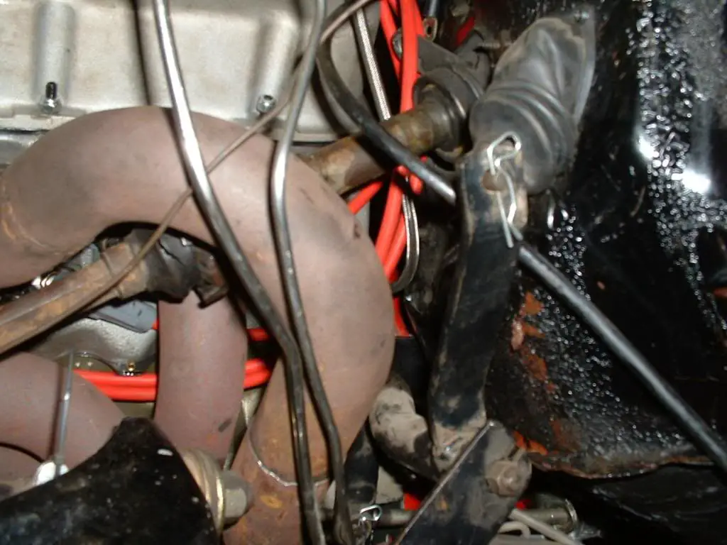

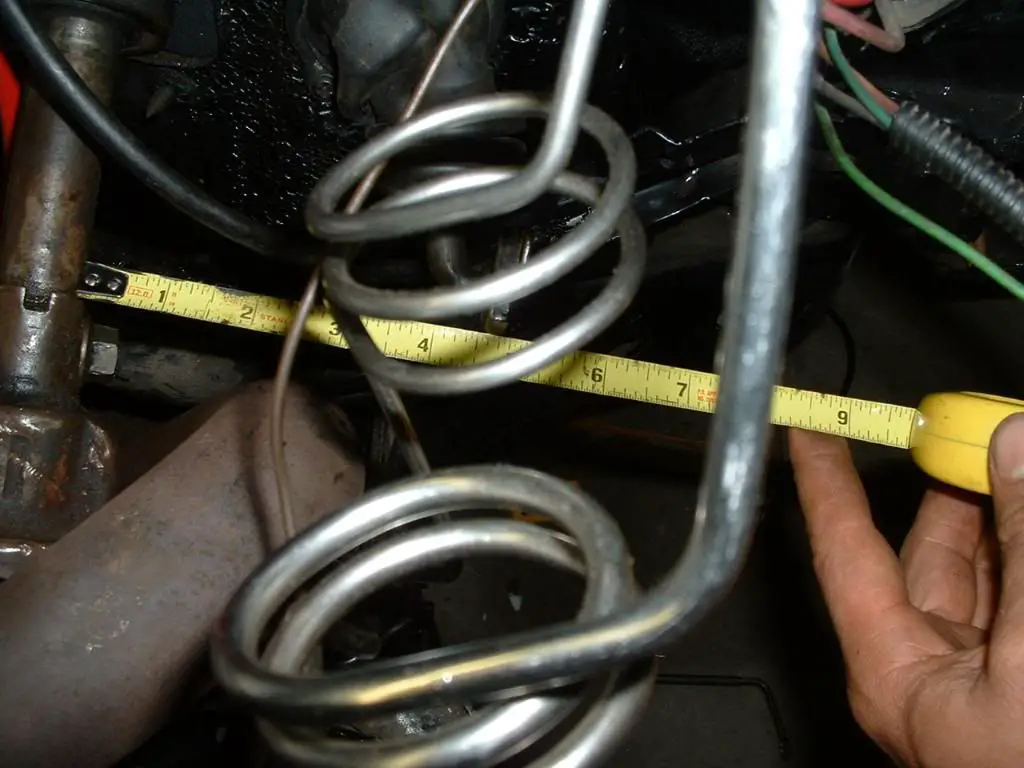

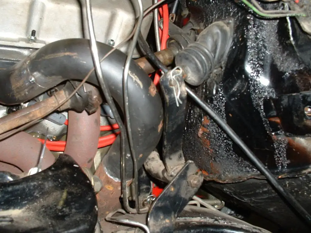

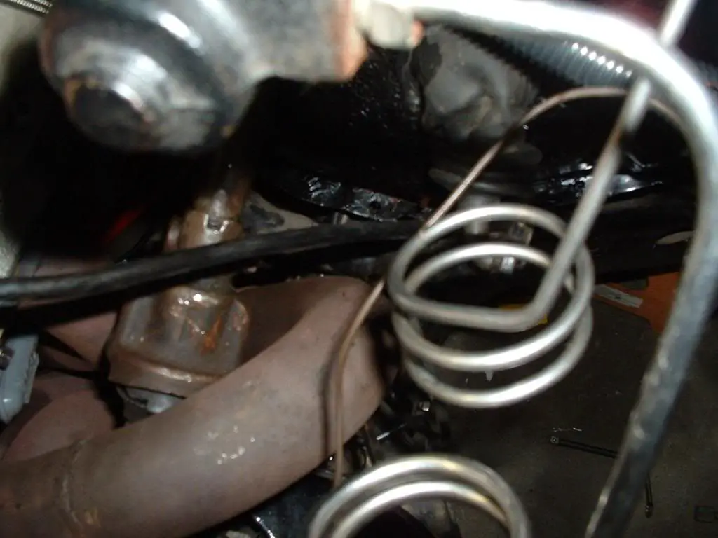

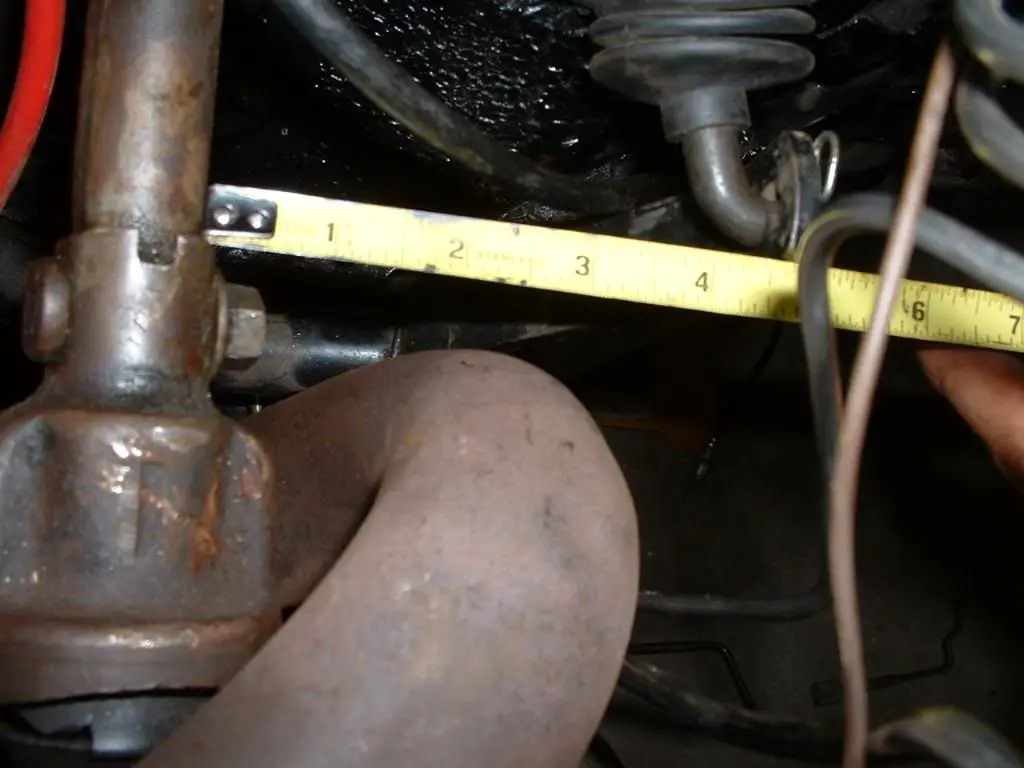

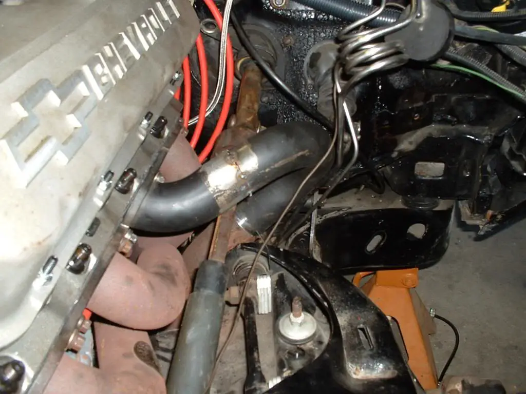

Here are some pics. The best I can remember You just need to shorten the tube were it goes into the header and tighten up the radius of the bend. The one on My car has been cut in the middle of the bend and welded back together.
Modified tube on top stock on bottom.
