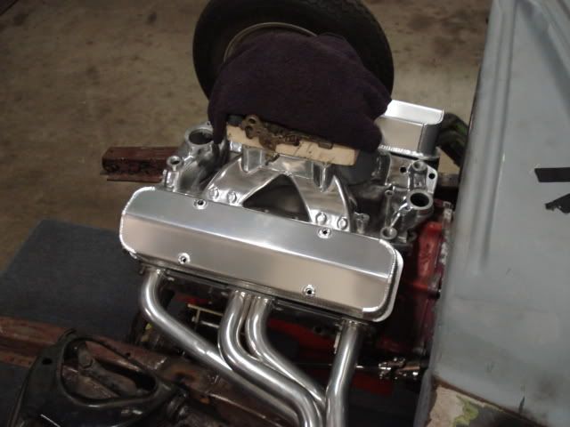

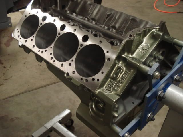

Hey guys wussup been alittle why'll since ive been on thought id share some photos of my build and motor, I've noticed theres a few 406 + engines in here and all the input has been really helpful in building my motor aswell.

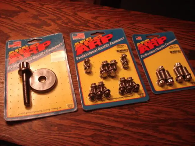

Motors about back from the engine builder now the short block is complete i'll get some pics of it soon, went and picked up a few parts from summit the other day to button up the botton end!

Specs on the motor:
70 400/ 406 ARP studs
10.5.1 Mahle forged flat tops
Scat crank Internally Balanced and Scat 6" rods
SFI dampner
TCI flex plate SFI
Cloyes Billet double roller
Mellings Select pump
Lunati Voodoo Solid Roller
243-249 @.050 585 lift
7 Quart pan with kick outs
PP Huricane intake 750 mighty Demon
Coated Fender well headers
3" Magnaflow Bullet mufflers
MSD igniton/ wires
CSR electric pump
Griffin Rad.
Still deciding on heads next purchase leaning towards
200CC IK Brodix or a set of 215cc Canfileds
Car will be mostly show car/ street car and plan on racing some super chevy events with it aswell,
Car will have a 350 turbo 3,500 stahl with 4.56 gears in a narrowed 9" with a 4-link. car weights around 3,200 lbs

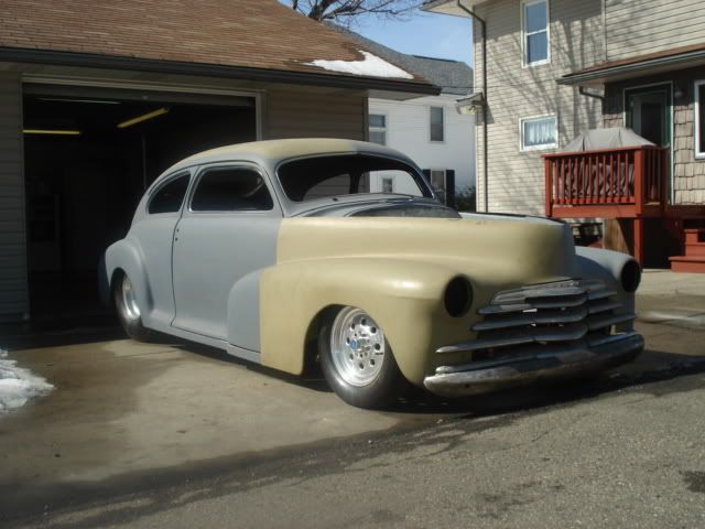

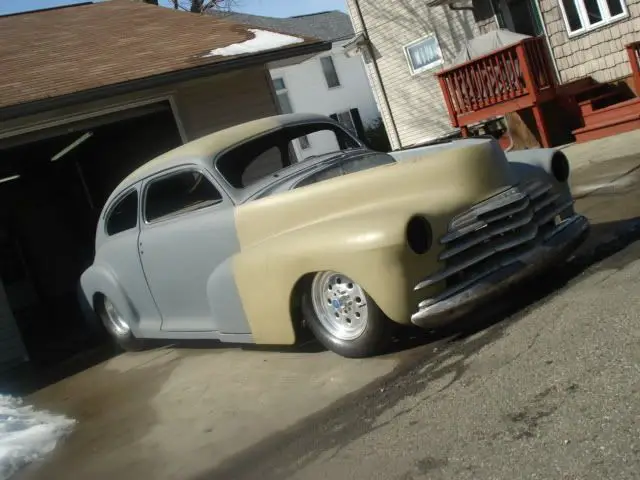

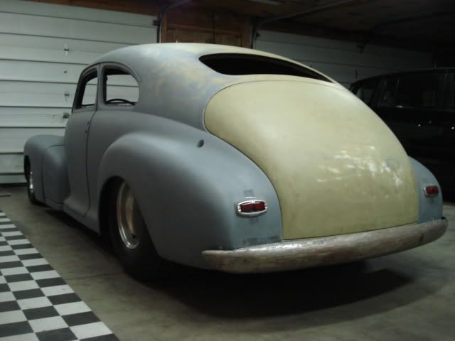

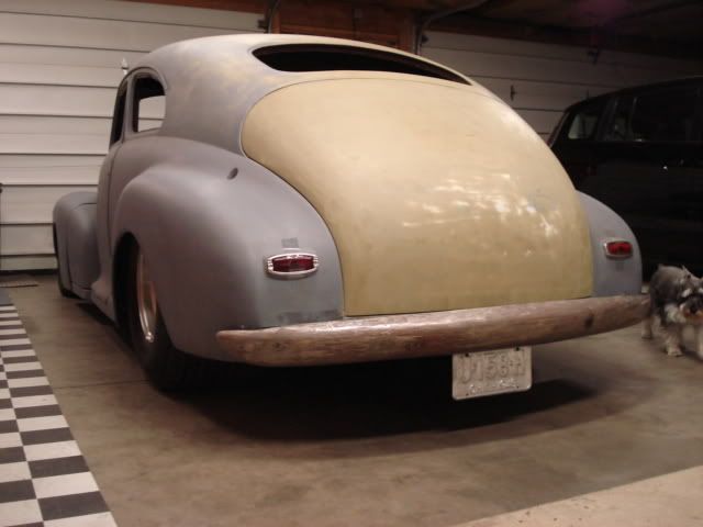

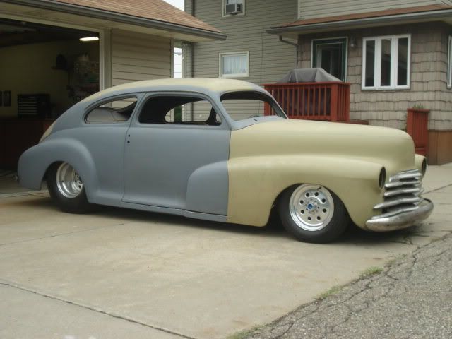

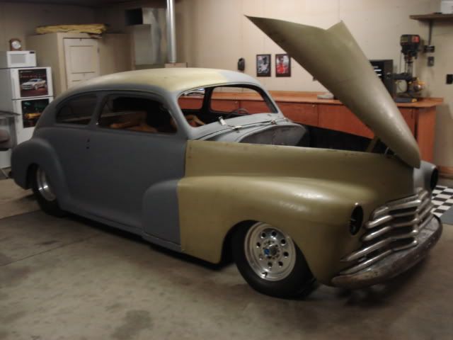

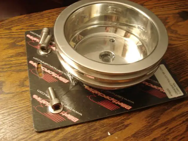

A few parts i picked up the other day to button up the botton end and a few of the car still in mock up!
PRO 48 Fleetline
Oct 16, 2007
230
Thanks guys!

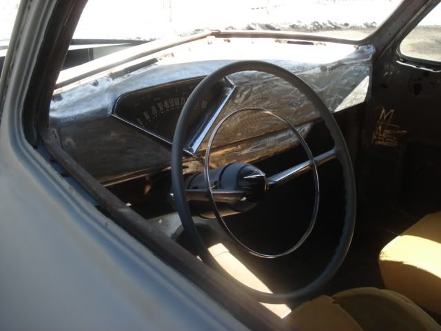

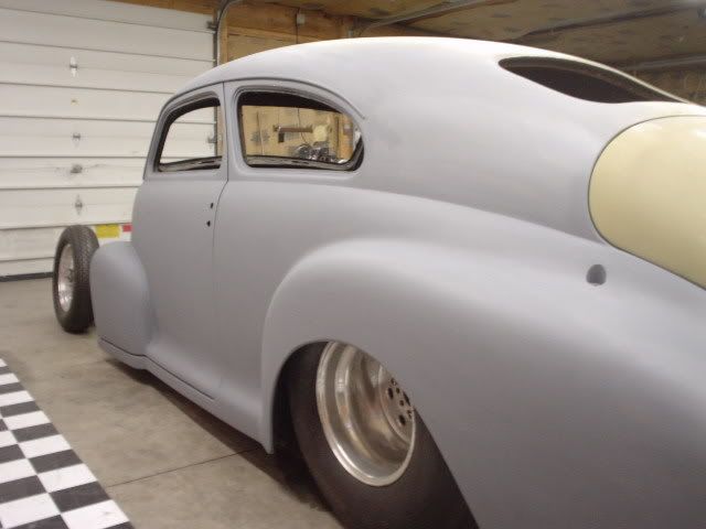

The car has been a blast to work on so far i have always wanted a complete custom car, and I have always loved Pro Streets, and the Big fenders slammed and on air was what i new i had to have after running across this car!
PRO 48 Fleetline
Oct 16, 2007
230

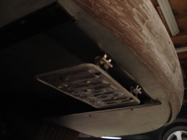

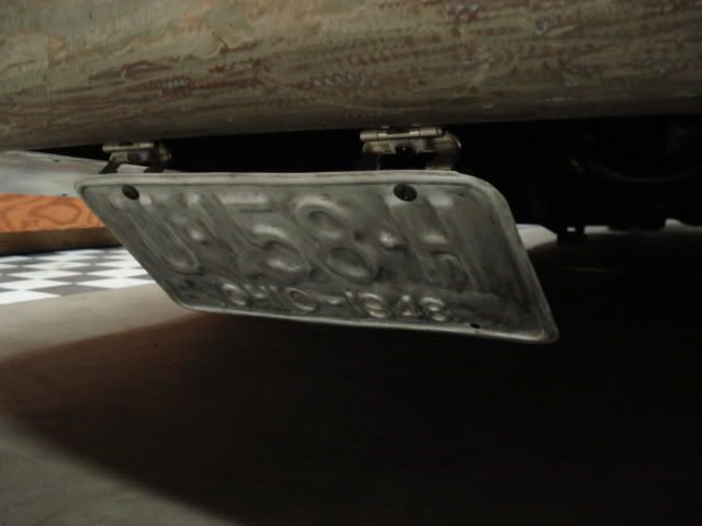

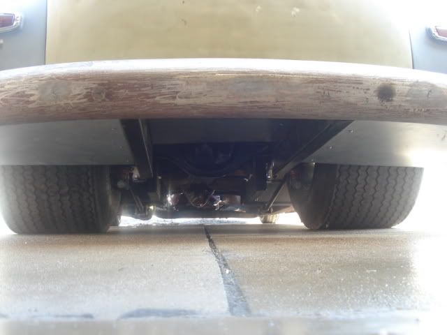

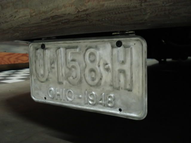

Oh and a custom built rear belly pan with flip down 1948 plates lol

PRO 48 Fleetline
Oct 16, 2007
230

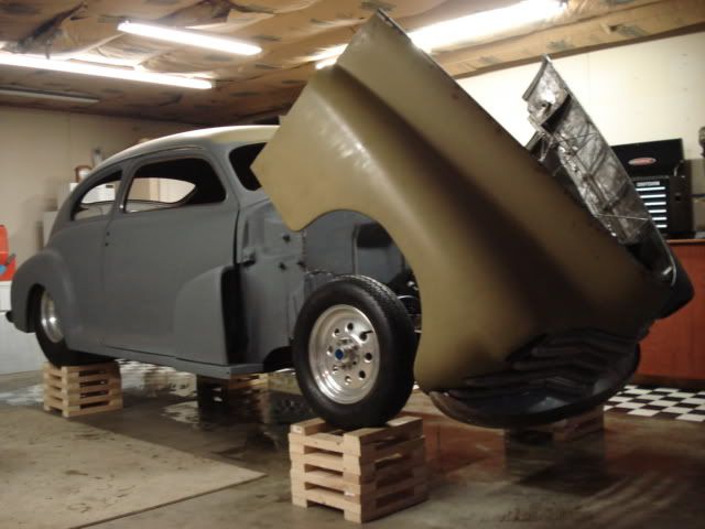

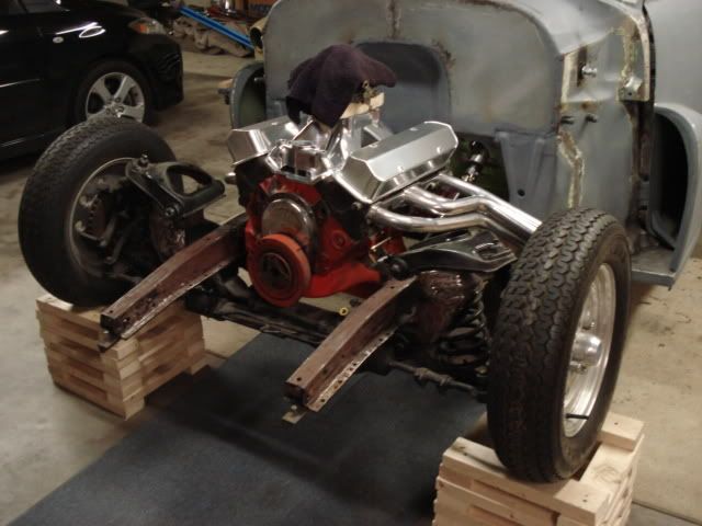

Dropped off parts today should have the short block back middle of next week!

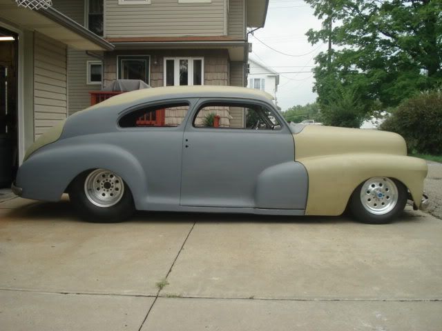

Trying to finish my metal mock up yet!
Like to have body off frame this summer so i can get the frame finally done and all ready to be smoothed.

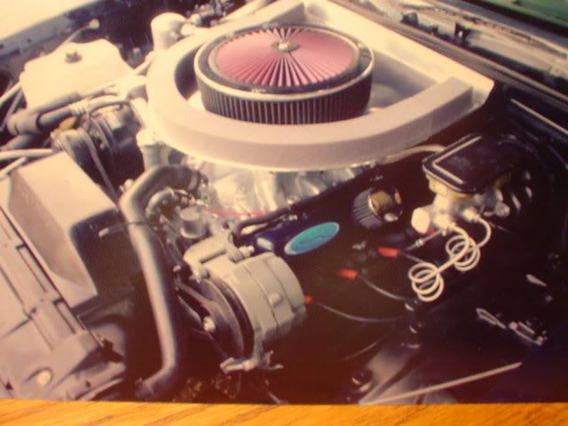

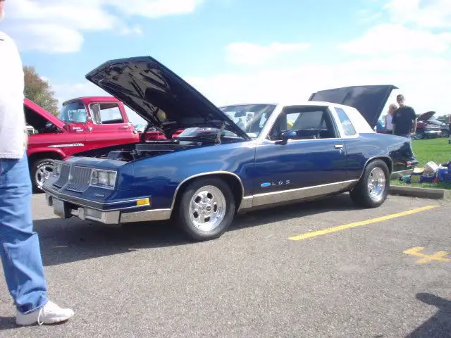

Also heres a few pics of my G-body i sold awhile back thus the reason im here. I love the g-bodys and I have a weekness for them but i really wanted a custom car and this olds was way to nice when i got it to make a custom out of, I even left the bench seat and stock radio in it lol
I did change the running gear 455/461 BB olds turbo 400 9" 3.90 gears Really fun car but just had to go faster,
I'll be sure to keep you updated on the 48 later George
