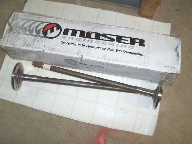

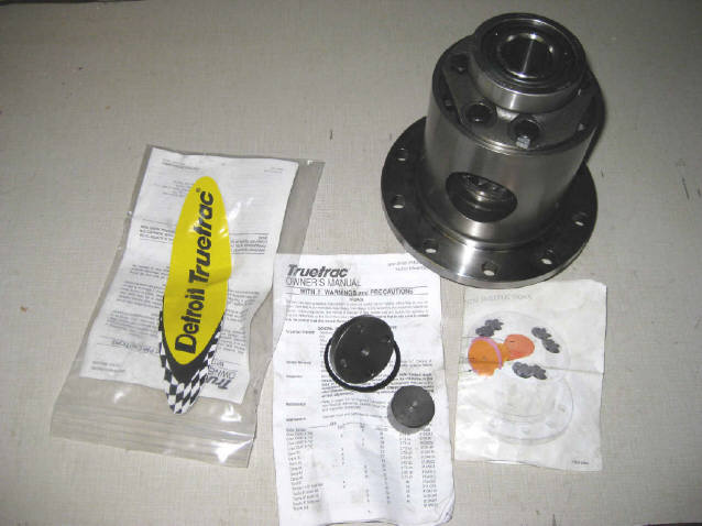

I agree 28 spline Moser axles I can get you for about 235.00 a pair
also have posi unit 28 spline 2 series that can have a thick gear installed to it which again I have . posi is 189.00 gear 3.42 3.73 4.10 thick are 169.00 NEW

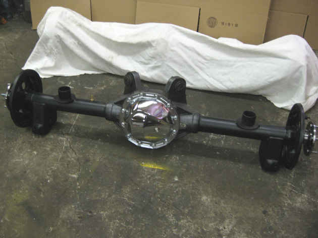

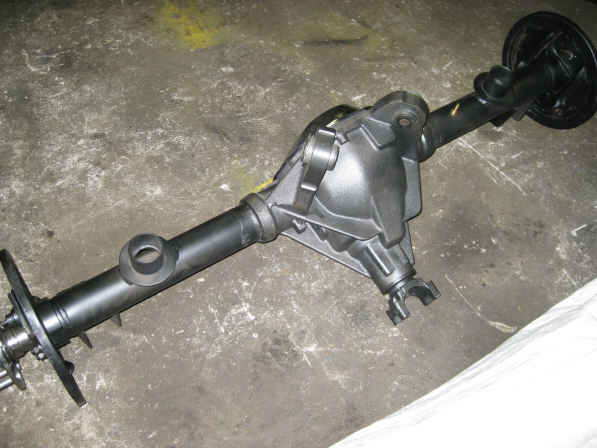

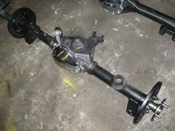

ORrrr why not just bite the bullet and get this MOSER 12 bolt rear...??? lol
2300.00 done 2500.00 with all new brake complete... I guarantee NO troubles here. I set-up the guts and assemble them. I do not trust anyone to set-up the gears and posi better....

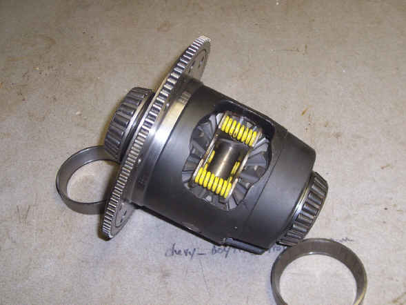

Came across this one on eBay, says it's an Auburn... is it rebuildable?
I'm also trying to get something straight about the 3- and 2-series carriers... a 2-series can be used with a 3-series gear with a spacer, but not the other way around, correct?

All cars received performance posi units and in the 1978-1987 g-body 7.5 they were ALL auburn units cone type.
I think the Monte carlos had the one piece auburn bodied unit like a barrel with a metal cap on the end in 1985, 1986 1987 ss montes 7 5/8 ring and pinion.
All the older G-body 7.5 received the split case bolt together carrier housing auburn cone type.
2 and 3 series info-
- 2 series open or posi unit can hold 2.14 - 3.08 stock gears and 3.23 -4.56 with thick gears made esspecial by aftermarket companies OR you can use stock 3.23 -4.56 3 series GM gears and a ring gear spacer.
-3 series open or posi unit can ONLY hold 3.23 -4.56 GM or aftermarket gears.
So you actually have more options using a 2 series carrier then with a 3 series unit.
You have pictured a aftermarket Auburn posi unit (limited slip unit)
