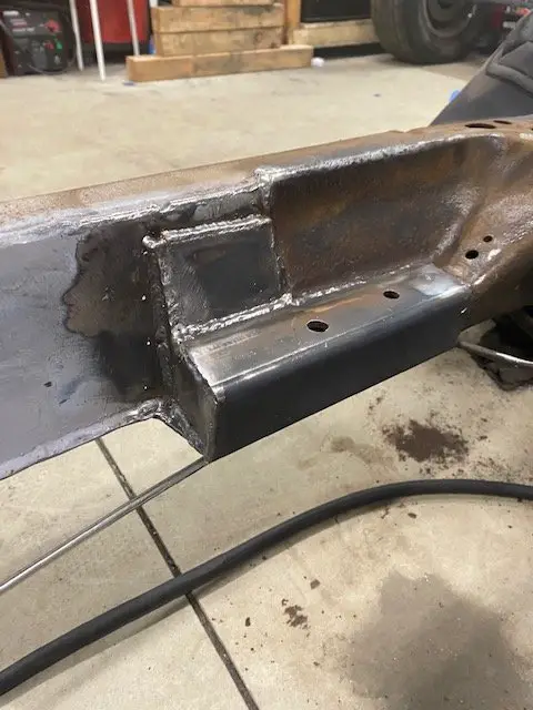

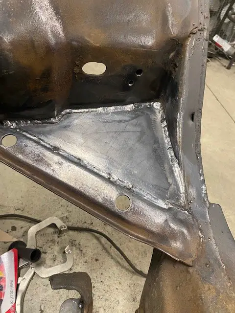

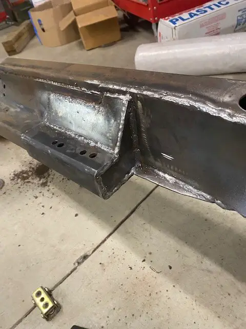

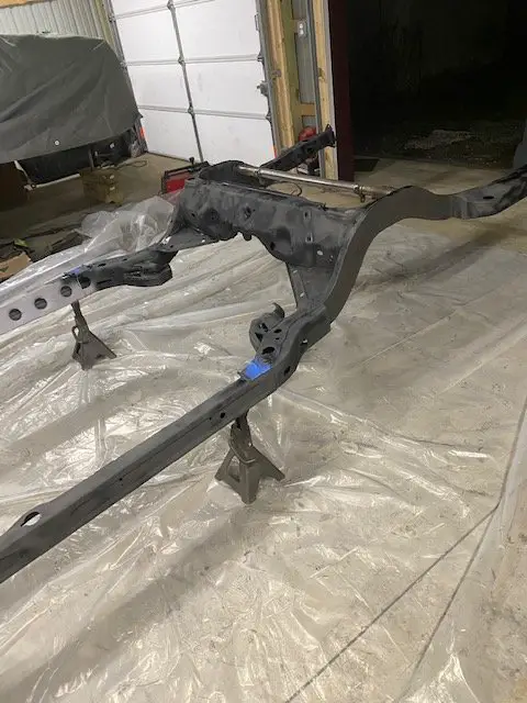

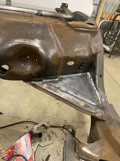

rear brace welded in, center section built, solid upper lca bushings installed, rear is all set and ready to go back
in
  • Like
Reactions: CosmoZL1
r_d_3
Feb 25, 2020
125
67
28
29
New Jersey

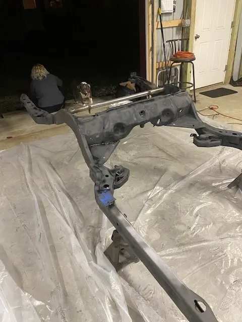

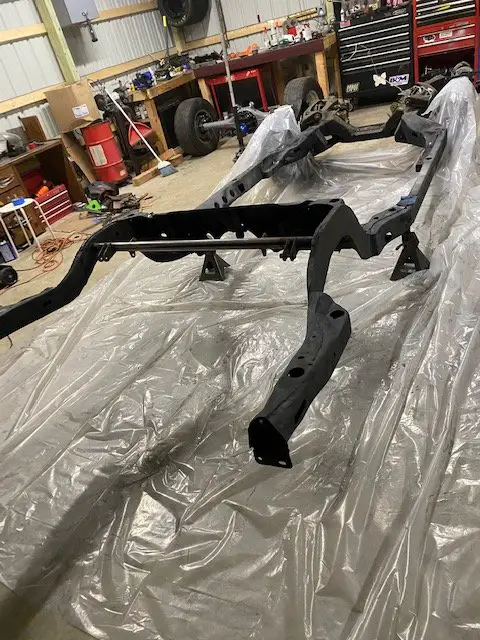

Put it all back together and got the frame rolling again, now onto rust repair under the body and then I can put the body back down on the frame.

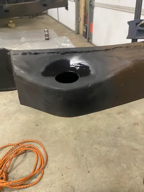

Do you weld for a living? They look great.
What primer and paint did you use?
Did you you insert a rigid bar inside the housing while welding the brace on, to prevent the weld from pulling the axle tubes towards the rear?

nope I draw on AutoCAD for an aluminum company for a living, and paint and primer was both rustoleum, the paint was a brush on style. For welding the brace on the rear I just put the axles and spool in and jumped around to try to keep heat down.
