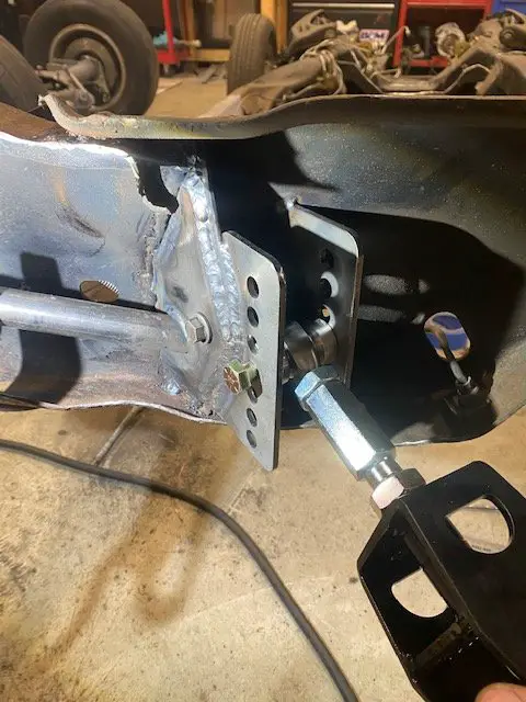

drivers side frame notch, made a card board mock up wheel 15x10 5.5bs should fit just fine

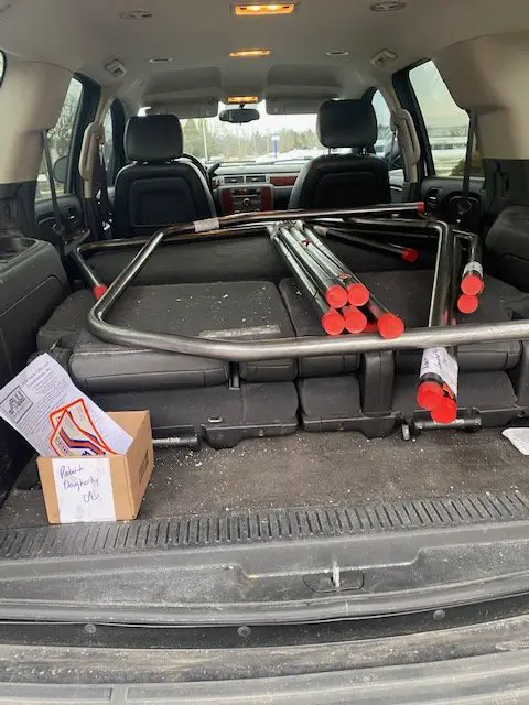

picked up my 10pt cage from S&W racecars on Friday, excited to get the body back on and start fitting this up.
Did you go with CM or DOM? I started with that same kit. Some my chassis builder used, some not so much. Will your rear wheels go under the fender? My problem is pulling the trigger on wheels. If those are 5.5 bs? Will they allow the car to sit level? Very interested. Thanks RD

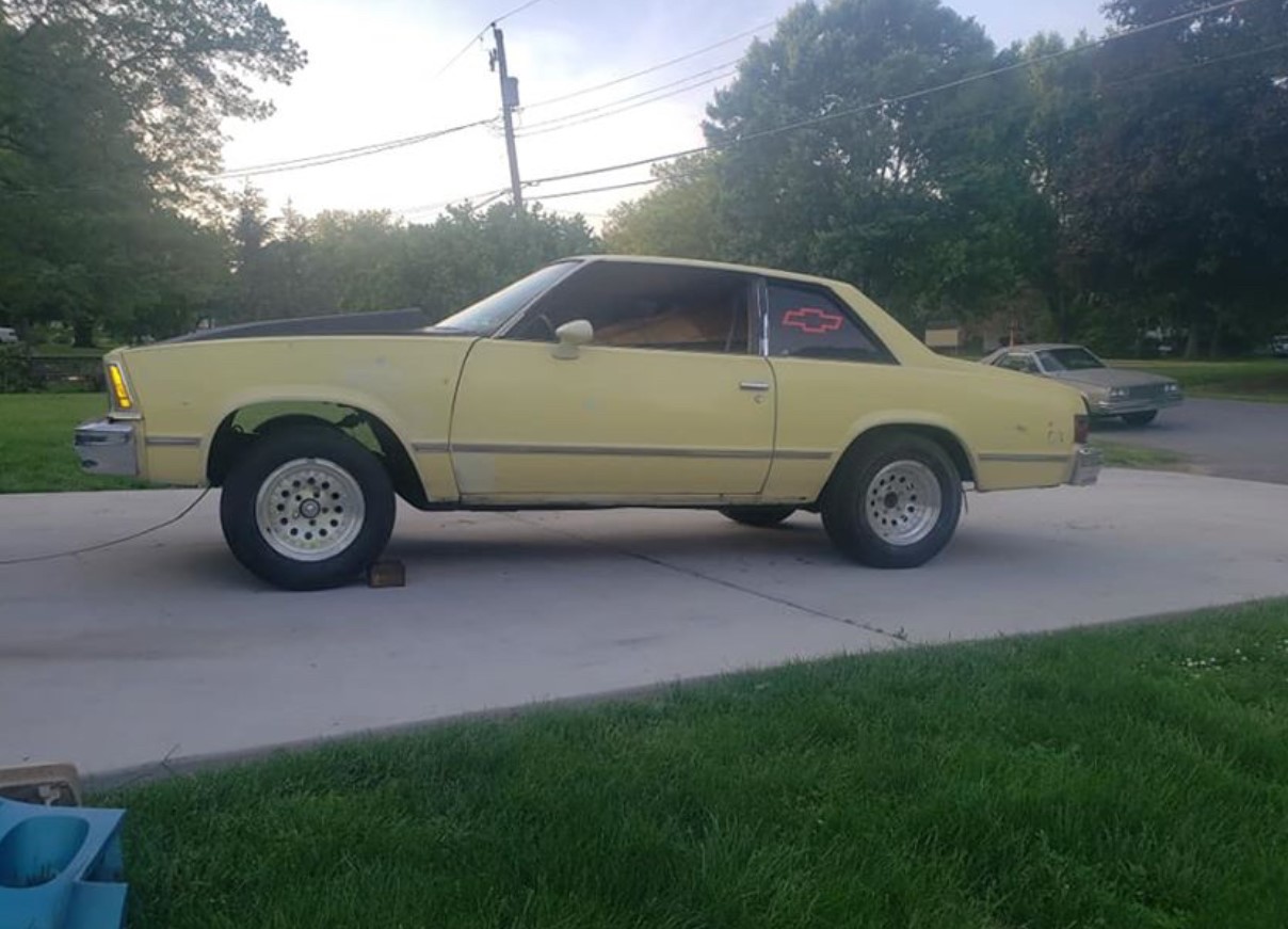

The wheels on the car now are 15x8 4" bs, I'm planning on going with a 15x10 5.5Bs the quarter panel will probably need to be rolled, but I wont know for sure until I get the body back on the frame.
