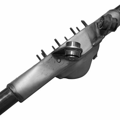

I bought a new Moser with 31 spline axles. With 31 spline you can use a truck center, not locked into dedicated race stuff. The Moser has heavy wall axle tubes and a new center housing. They set the pinion angle into the brackets per my request. It uses GM backing plate bolt pattern, so, mine has Chevelle backing plates and brakes (drum) withpark brake cables just like the General intended.
I ordered mine thru a racer that is a dealer,it was $850 shipped for housing and axles, 4* down pinion angle, uses GM backing plates (centers cut to clear big bearing Ford). I picked up a used center and 4.10's and a spool.
31 spline axles will support and enormous amount of power...
Seems like I have about $1600 in mine, with a the Daytona pinion support, forged yoke, new brakes, etc...maybe a little over that.
