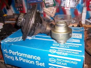

how deos the carrier split to install the spool ? I tap'd on it some but rather not beat it to death till I get some advice !

That looks like a Detroit locker. If is is you don't need a mini spool. If it isn't it will not work with that type of carrier I don't think.
