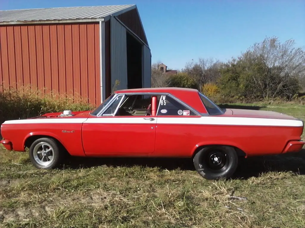

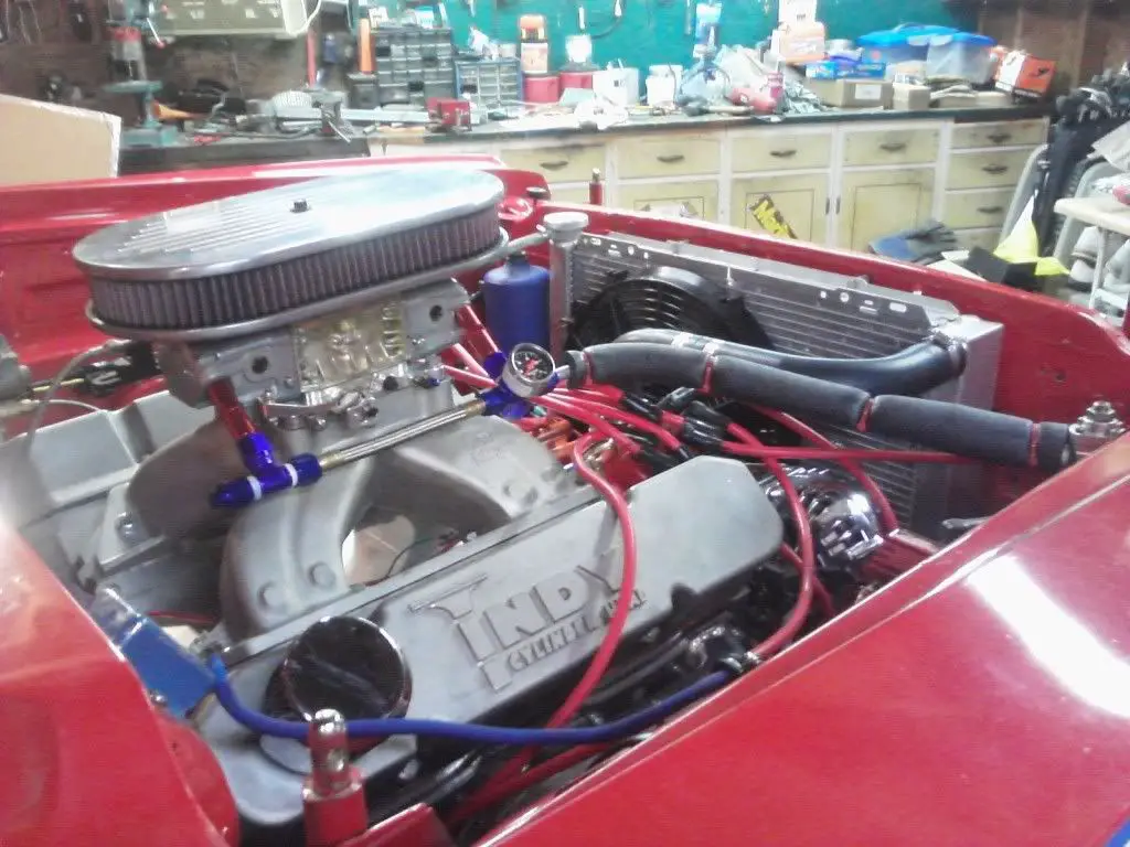

I knew this was a race motor only but was just hoping to use it on the street so I could get some money back. I really don't want it to just sit on the stand and go to waste. I knew that the stock iron heads I put on the motor weren't the best but cash is limited! When I built the motor I was hoping for 12.80 with the combo so I am not disappointed in its performance, since I had NO idea what I was doing. Just wished I would have known then what I know now. I learned alot about combos doing it and reading other post from this forum. You guys are great. Even though I wont be running the Bu again I still check this forum alot. I like car knowledge.
I went back to running my Mopar(65 Dodge Coronet). 426 Max Wedge car. I built it to run in the Nostalgia Super Stock series. I run it in the 10.50 index.
I am selling my 79 Malibu to finish up this project. I didn't think I would hate to sell the Malibu but I have alot of time and effort in the Bu. I grew fond of it. If the deal falls through on the Bu I may just keep it and do some tuning on the 355 so in a couple of years my oldest can run it at the track. It will make a good safe starter car. I put a 8pt roll bar in it for that reason.

The arm and leg thing is why I went with the Chevy to start with. I need close to $2500 just for an Indy Cylinder Head NSS legal intake and carbs. The 65' was a Cruz night/show car so we didn't want to mess it up to race it. One day my father and I were talking and found out that we haven't driven the 65' (4years) since we started racing the Bu. We then decided to swap it over to a strip car so it would get some use. Didn't realize how many Bu's were at the track. You don't see very many Old Mopars at the track so the looks/questions about the car KINDA makes up for the money spent. KINDA! I had tons of fun running the Malibu. I am sure I will have even more fun running the brand I grew up loving.
I will always have a soft spot in my heart for the Malibu. AND I will always hate Mustangs.
