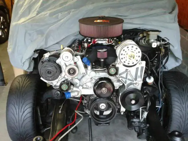

Bringing this back up to see what size belt you guys are using, I'm going to measure still, but looking for a couple numbers to shoot for.
My setup appears to be close, not exact though. I've looked around on the forum a while, just joined today. Have had this page saved on my computer for a while
Looks good :D Now show us the rest of the car! :D

Gotcha fooled, its an s10 blazer :oops: Don't wanna hijack a Malibu forum thread with s10 blazer pics, lol

Ended up using a 109.25 inch belt, (K061093 dayco), that should put a range up for most guys doin this. For guys that don't know , the last 3 or 4(if its above 100) is the length of the belt in gates and dayco. Not sure on other brands The next shortest is 109 inches, next longest is 109.8 inches
