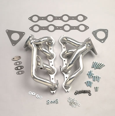

I know this isn't really a horsepower-related thread, but for anyone looking for a shorty-style header (as I may be), it may be viable to run a set of Camaro/Firebird headers that bolt up to the OE exhaust, since the collector should end up in the same spot.
http://www.summitracing.com/parts/EDL-65732/

Those do fit with or without AC. If you are running A/C thoough, and keeping the air box on the firewall, it may be better to use the vette shorties. If I remember correctly, they dont have the EGR/Air pump ports, and are more swept back. I mention this only because the maro shorties were rather close on my swap.
