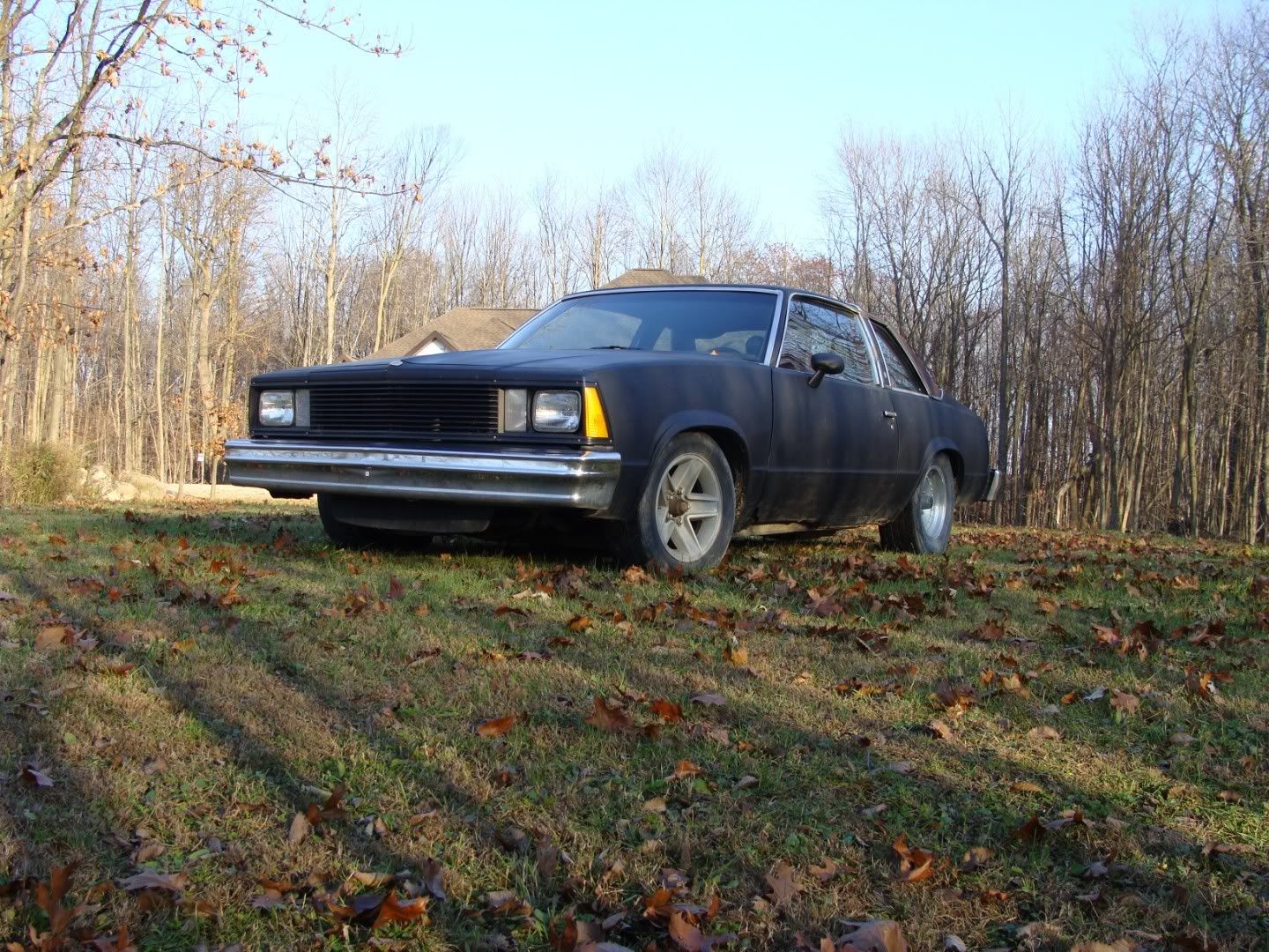

Hello guys. Just figured I chime in. Im running the Hotchkics TVS system and UMI front control arms in my Bu. I love the way she sits. At first it was kinda stiff but the springs are settling in now or Im getting use to it. Lol.. I have no rubbing issues at all. My profile pic is how it use to sit, now the front tire is slightly tucked in the fender. No rubs at all!

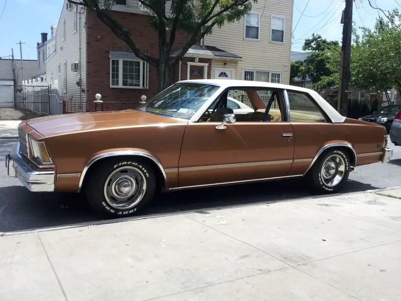

Brown g body yours looks low and reassures me a little. Are u rubbing aluminum or iron heads? I have aluminum heads on my small block
