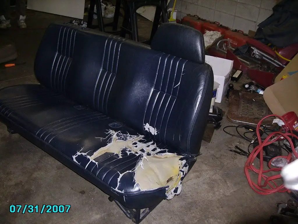

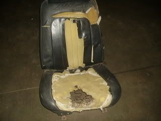

I tried looking at local places like joanne fabrics, I was just going to shape my own but that stuff is 75 dollars a yard..little too much for my wallet so what are my options?

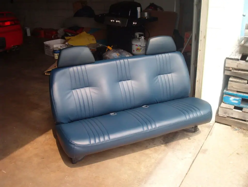

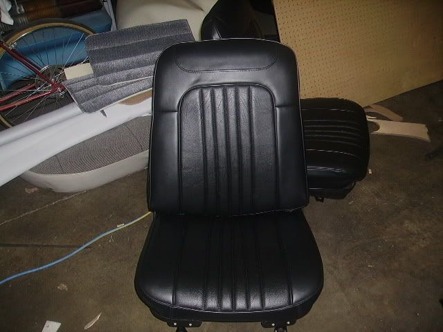

Depends on what you're doing. If you're just patching in a bad spot, just take a old eletric knife and make your rough shape, the take a angle grinder with a 36 grit disk, and slowly re-fine the shape of the new foam to the old. But let the glue dry out over night after you make the patch.
If you are rebuilding the entire bench seat foam, it's pretty much the same way as fixing a patch, just more time doing it.
