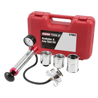

If you are worried about it go to Autozone rent (free) there radiator pressure tester.
This way you will know for sure it is sealed.
Before you start dumping coolant into the oil and wipe a bearing.
The one Autozone has will fit right onto the raditor neck.
Advance Auto has one too but you need a rubber adapter to use it.
