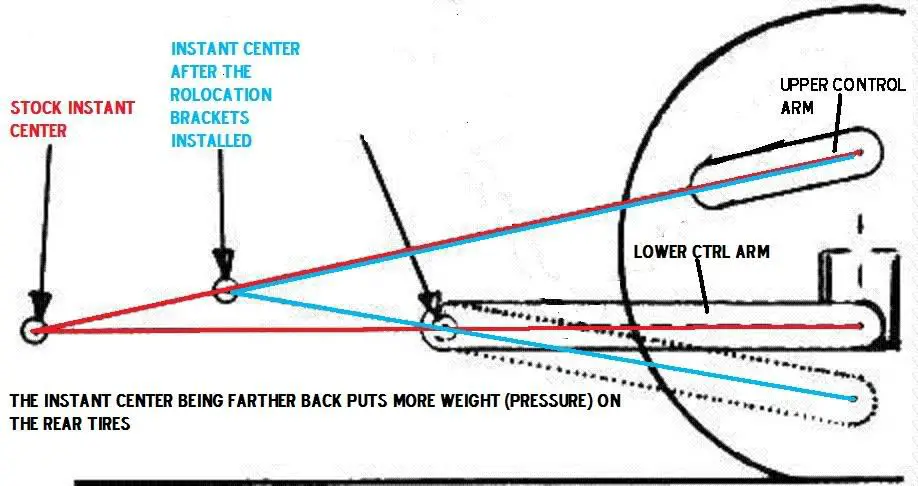

I just wanted to throw this out their for you guys! That UMI Performance also offers a set of lower control arm relocation brackets. The relocation brackets eliminate wheel hop and increase your traction performance by allowing you to adjust your lower control arm more parallel with the surface. We offer two versions a weld on and a bolt on! Below is a link to show you what we have to offer!http://www.umiperformance.com/products.php?category_id=17If you have any other questions feel free to ask and I will be glad to help!ThanksBrad cool.gif
Ok, I have a question about this. In your post it says that these brackets help to keep the lower control arm more parallel with the surface. Every set of these I see installed the lower control arm seems to be pointing towards the ground instead of parellel to the ground. I know on my car it is lowered a little and in stock location the lower control arms are very close to parellel to the ground. If I installed these brackets on my car, my lower control arms would be angled more downwards than parellel to the ground. I am just trying to understand if they drop the mounting point on the rear of lower control arm how does it make it more parellel to the ground, especially on a stock height car where the rear lower control arms are already pointing downwards to the rear end.
I just don't know if I need to use this type of set up or not. I have read in some of the threads that the relocation brackets work well in low HP applications, but I just don't know where I am in that. My set up is sbc 400-450+hp, 3800 stall, crazy built th350, 12-bolt 4:56 posi, full notch 325/50 drag radial, PST 1 1/8" rear sway bar, comp eng adj shocks all around. Car is stripped two lightweight front seats, 10point cage, alum dash, etc... I plan to stage on the 2-step module around 2500rpm, but will have to see from there.
