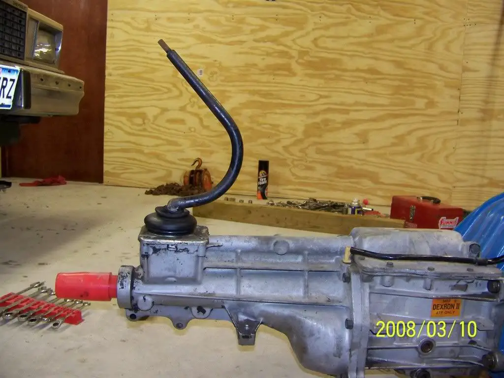

Lakewood makes the 15032 Bellhousing that will allow me to attach the Mustang T-5 (which is more available than the Camaro V8 T-5) to a small block Chevy (or Chevy 90 degree V6).
The other trick is that I will need a custom welded stick to move the shift stick fwd and allow me to keep an unmodified bench with the aft location of the Mustang's internal shifter. I've already sketched out a rough idea that should work.
why not use a box out of an s-10 if you arnt going to be bangin gears or racing. If its about mpg, $$, and shifter placement than thats your box.
If you do go with a camaro t5 heres how I did my shifter to work with the bench. You cant slid the seat all the way fward but far enogh that most people wouldnt have a problem ;)

Firebird box, saving money...more work...hmmm... :-k
I actually once considered buying an S-10 box from Doober but quickly talked myself out of it. The problem is that I might want to take Darwin out to the strip some day and I do occasionally burn a little rubber and it would be nice to have a driveline that had prayer of handling the (relatively mild) abuse that my V6 might be able to to dish out.
