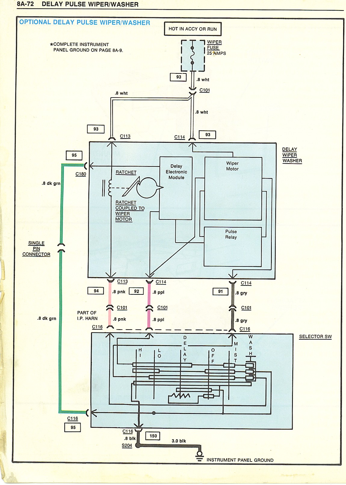

Put a 84 tilt with delay in a 83 non titl no delay car. Got a 83 delay wiper moter and wont work, was woundering if i could swap some wires around or add some to make it work. Thanks for the help, Brian.

yes i found it but that one doesn't tell me what the white wire that comes from the switch does. matched up the colors under the dash hi works and park works thats it. the switch doesn't have the black wire but has a white one, witch i belive is a power.
I put delay in my wagon, The wire colors are all different. You are better off ringing out the wires that are there to do what you need.
IOW, the delay has like 5 wires, but non delay has 3 or 4, you have to add a wire, then make sure whatever wire color u use goes to the right place. Find out which is the power, leave it be, and hook it up like that diagram doober posted.
