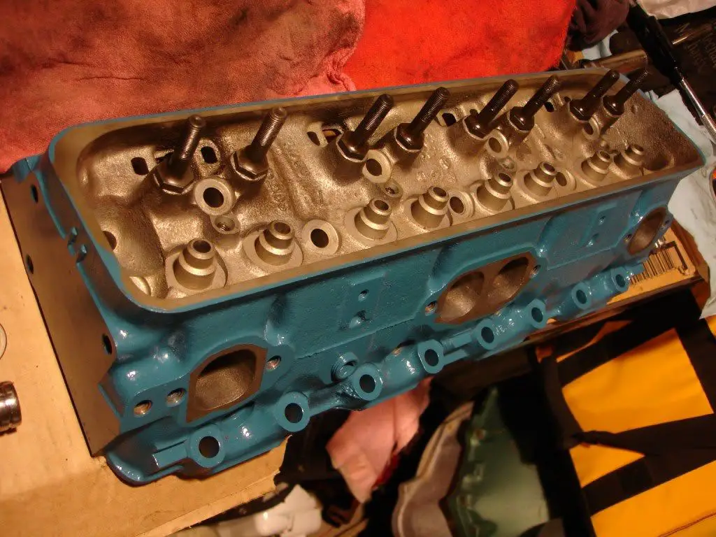

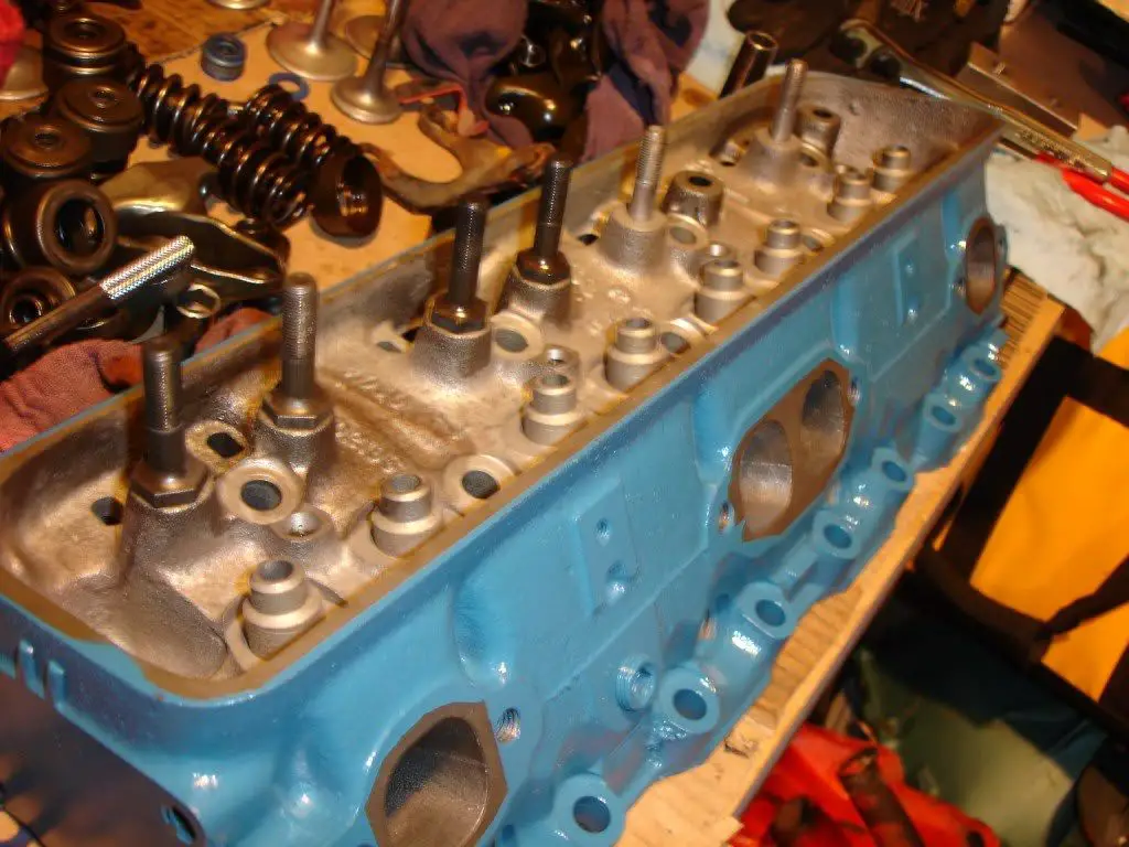

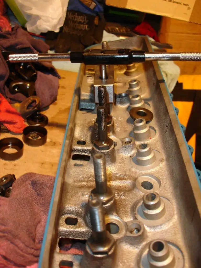

I don't think that's gonna work either. The Stud Bosses are usually Milled down about the thickness of the Hex shoulder on the screw in Studs. Rocker clearance, Valve train geometry will be wrong. If you even have enough thread for adjustment.
