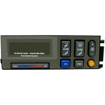

My plan involves the controls for the late '80s/early '90s GM trucks (GMT400 platform), possibly the late '90s if the controls are still the same and the control head isn't too big.
Early GMT400
Late GMT400
I started doing some looking and discovered they use a motor similar to the NBS (GMT800, '99-'06) and possibly newer trucks.

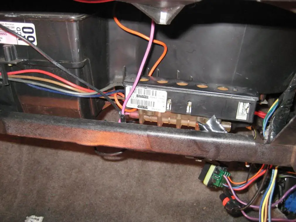

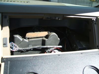

The early controls used relays to run power through each blower speed resistor, I'm not sure about the later ones though... it's not real clear but you can see the relay bracket here (behind where the glove box mounts):
My thought is it should be possible to just tie it in place of the factory G-Body relay module in the engine compartment, matching the speed settings up to the relays for the newer controls, since many/most of the GMT400 trucks had 4 speeds like the G-Bodies (not all, I had an '88 Chevy with manual heat/defrost controls and low/med/high with a mechanical switch).
