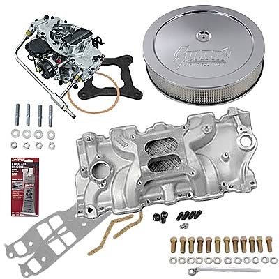

In summit racing found this carburetor manifold combo. I like to know your opinion..
Im not bluilding a high performance engine, but y want to build a solid one with good power for a daily driver. I have a TH700R4 transmission and installed 4.1 gears keeping the 7.5 rear end, at least for now...

It has 2 bolt main and flat tapped cam. I was looking for a summit racing brand distributor and the same brand combo intake manifold and carburetor of 600cfm acording to the info...

I need advice here, Is this a good cam, i still have to choose the proper intake and carburetor, so i would like a more experienced opinion. This or other cam with a X or Z carburetor and intake.

I think for what you want the 204/214 will work fine. Edelbrock Performer intake and carb 1406 will work with that Camshaft.

But if you said that Ex 268 give better performance i will go for that one. Iwould keep the stock valve train and lifters, no problem with that? and the intake you said and carburetor work fine with this cam...
