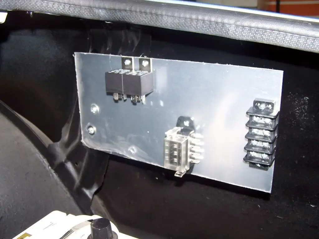

Do you have a closer pic of your relay panel I am going to make one for my car...But I don't want it to be a wiring nightmare and your looks very clean....Thanks

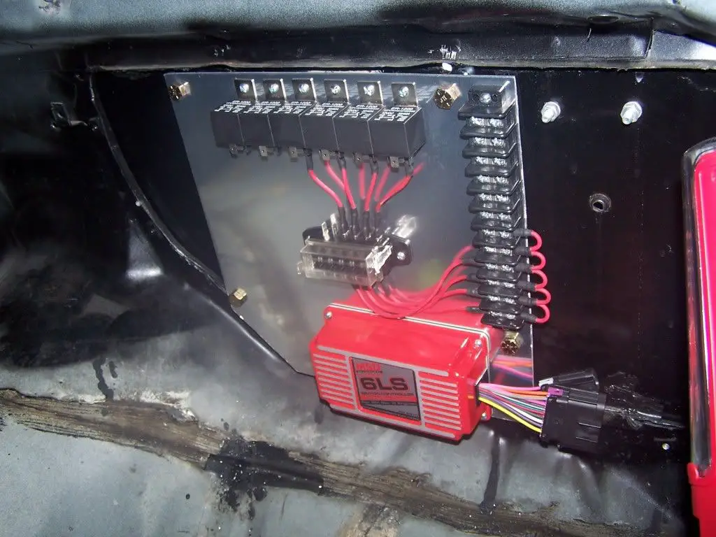

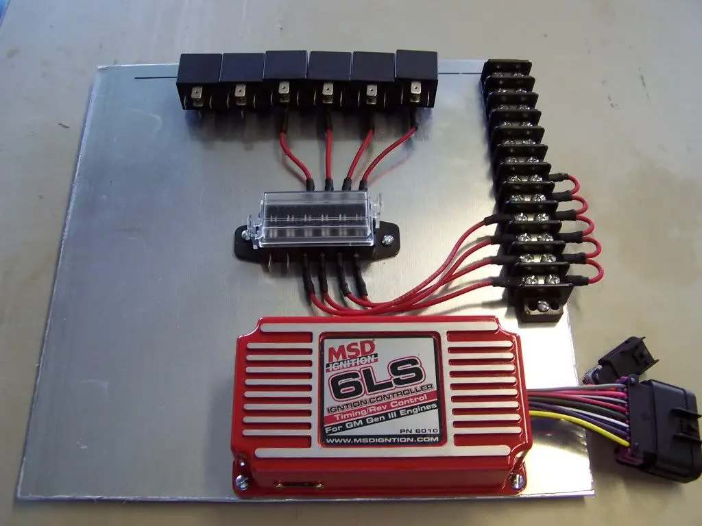

Thanks man! These are the only other pictures that I have of my relay panels. I made a front and rear panel just to keep things a little cleaner. The nice part about the rear panel is I only have a single wire for each relay going to my switches.
