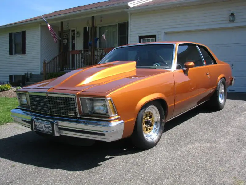

I just installed some TRZ Upper&Lower controll arms along with some Wilwood discs up front. I have 15x4 Weld Magnum wheels with 1.25 backspacing. The brakes pushed the wheels out about 1" and now I have clearance issues because the car sits low ... I was told this is a common issue due to the hub design ](*,) and a different BS wheel will solve my problem....GREAT, I just spent $900 on these front wheels last year ](*,) ...SOoooooo NOW I will have to sell these but before I do I was wondering if anyone ran into the same issue OR has a 3.5" wheel with a 1.75 BS (with Wilwood brakes) with no problems??? As you can see in the pic below, the 4" wheel fit perfect BEFORE I made the front end changes. I also have a matching set of 15x8 with a 3"BS for the rear if someone wants a killer deal on the set of 4 wheels. I have 15x10 on the rear now.
