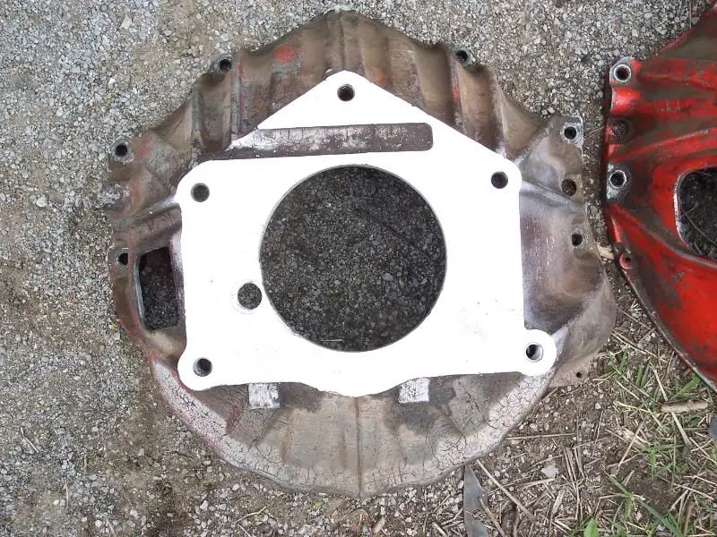

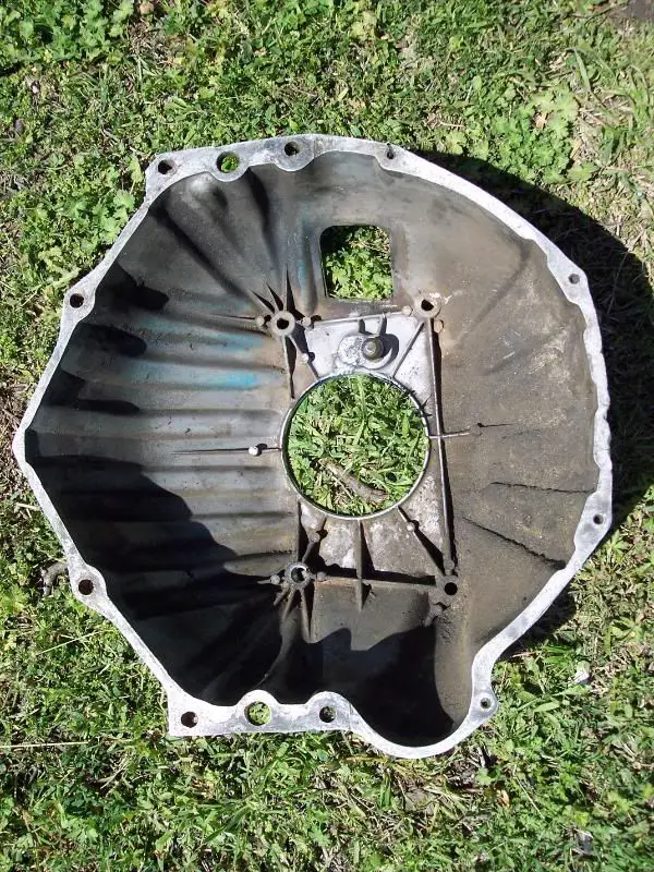

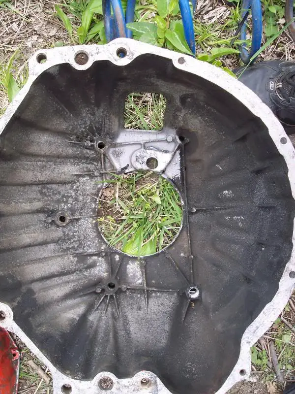

Some pics of the bell housings I had altered:
Too make this all work, I opened up the hole for the fork down-ward to the rib.
I had to end up using the 12" bell housing to clear the clutch/flywheel appilcation on my 454. Mine is working fine with a normal clutch fork from a local parts store.
To make the 12"/truck bell housing work, the hole for the pivot ball was welded up, a boss was welded inside the bell housing. Upon setting up for the new lower G-body specific hole, it was going to be close to breaking through on the larger front bearing retainer hole the transmission sits in, so, I turned the outside of the pivot ball down on the lathe about .040. I purchased the special thread tap for the pivot ball. The guy I use welds them up, repairs any stripped holes(with heli-coils), decks the transmisison surface, and drills, counter bores, and taps the hole in the right spot for $75. He'll cut a break if he can do several at a time, then he doesn't have to re-set-up the mill.
I will take a pic of the opened up hole. It is probably too large, but, not that it is all in place, I'll make a template so its a smaller hole, with a tighter fit.
I also found a guy on ebay that sell a front bearing retainer that fits Muncie & Saginaw that fits the truck bell housing for like $48.
I had two 10.5 inch bell housings altered when I had the two in the pics done. If anyone wants one. Let me know.
