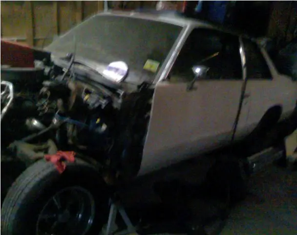

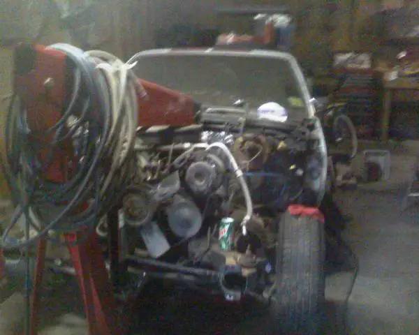

ok guys wish me luck ..lol..hopefully order my scat stroker 383 crank friday!!!!!!!Got pics just gotta figure out how to get some posted to start the build thread
