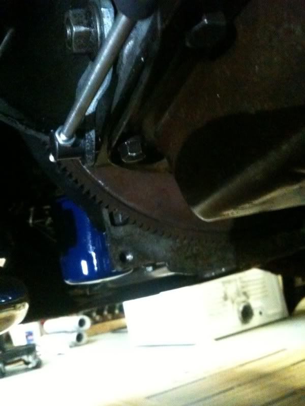

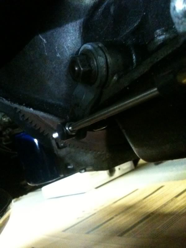

This is the way I have it on now.

I may have found a missing piece of the puzzle. I don't have the bracket that attaches to the Trans pan and holds the cable in place. Would that be a big factor causing the the entire cable to move rather than the rod inside the sleeve?

Well at least I know what to order to fix the problem. Maybe when I'm seeing the cable try and push or pull in the wrong direction is the fact that the cable is physically moving and pushing/pulling itself instead of moving the transmission lever.
