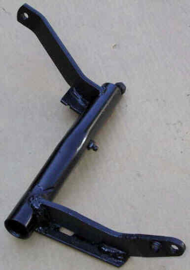

My first guess is that the lower arm of the bellcrank is peeling away from the shaft. It will need to be put back in its proper location and then a brace welded to the tension side of the arm to prevent it from peeling again.
I have seen this happen several times (even to me while driving). The factory welds have hardly any penetration.

i took the car to my buddy shop and they pulled the trans.. we looked at the z bar and yes it had peeled so they are gonna weld a bracket to it...
