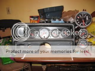

I preferred to have them all in the panel, but I just couldn't make it look good. I had a friend lay it out for me using CAD. He tried but it just wouldn't fit. See photo I took of the drawing below:
You might could swap the angle of the smaller gauges (move top gauge towards outside edges), but you would still have the bottom gauge partially covered by the plastic bezel. With the curvature of the plastic bezel, it would cover more of the gauges if you moved the bottom gauges in toward the middle.
BTW, the inner ring of the gauges in the drawing it the actual hole size. The outer ring is the gauge bezel size.
This is how I decided to mount my other two gauges, in the plastic dash pod bezel:
Hope that helps...

Hey Mr.P,Phillip that is,
That's going to be a Killer Ride for your young un when you get it all wrapped up!
I'm doing something similar although a bit more radical with my guage set up and was wondering about the resistors you used to calm the leds down as I was playing with mine and they are rather bright! Let me know where you got them and so forth,
here's a pic of mine
Thanks,Dave
