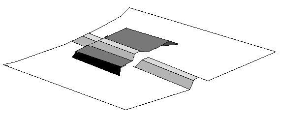

Ok, so I had an idea on what to do but it may look dumb, and wouldn't be very plausible, but its worth talking about it I guess.
Basically, I'm thinking of cutting out the "hump" in the section that I may need the hood clearance and using that to weld onto something like this...
http://www.magnumforceracing.com/cars/69_hemi_dart_wrecks_to_riches/hemi_dart.jpg
So basically taking the section of the hump, welding it to a few pieces of steel that will box it in and raise it up.
I know it seems like one of those little ideas that will never happen, but, oh well. lol

That looks like it would work.
That's sorta what I had in mind when I suggested making your own cowl scoop. You would have to taper the sides and weld the front directly to the hood.
A 60s era Vette L88 scoop would be similar. They used them on some Yenkos too. Those Vettes have a wedge shaped bulge like our Ponchos. The scoop straddles the bulge.
