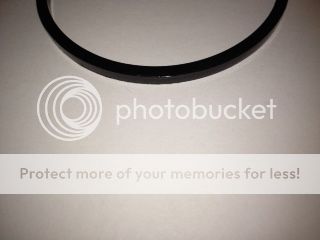

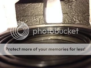

Though the description says "low drag seals", the seals are square with no noticable taper.
The seal-groove in the bore of the caliper are also square with no noticable taper.
When the seal is installed, it barely clears the top of the bore, and because of this, the piston to bore clearance, it seams, to have fairly tight tolerances.

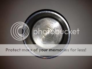

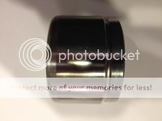

The small end of the piston is what contacts the back of the brake pad. It measures 2.38".
The large end of the piston is what is inside the bore of the caliper. It measures 2.50"
Inside of piston cup, facing the brake pad.
Backside of piston that is installed inside the caliper bore.

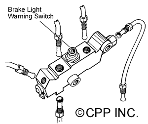

I pulled this information from the CPP website. I include this information on this thread because, during a manual brake conversion, the differential valve in the proportioning/combination valve may be triggered and cause only one side of the system to work resulting in poor braking performance.
The differential valve is built into most GM prop valves. It is for safety. If one side, front or rear, of the brake system looses pressure, the differential valve is triggered blocking off the low pressure side of the brake system so that the master cylinder can still provide pressure to the other side of the brake system. This ensures that there is some for of braking as a way to stop the vehicle. If a differential valve was not part of the braking system, and there is a loss of pressure in one side of the system, the master cylinder would not be able to build pressure. This would result in NO brakes.
Combination/Proportioning Valve Test
Use a test light by attaching a clip to a positive contact on the vehicle and touch the point of the tester to the electrical connection of the combination valve. If the the light does NOT come on, the valve system is operating correctly and no further testing is required.
If the light does come on, this indicates that the pressure differential valve is stuck in the front or rear position.
Bleed the brake system to determine if the front or rear lines are blocked off. Set up one front wheel and one rear wheel for bleeding at the same time. Crack both bleeder screws and gently pump the pedal a few times.
The blocked side will trickle fluid out when the bleeder screw is cracked and the pedal pressed. An unblocked line will squirt fluid out the bleeder.
The lines that are clear must be left open and the blocked lines should have the bleeder screws tight to cause pressure to build up on that side. Be sure to use the standard bleeding procedures to prevent air from entering the system.
Slowly press the pedal with steady pressure a number of times until the light goes out; this will center the differential valve. You may also hear a pop come from the proportioning valve. This is the metering valve returning to its equalized position. When the light goes out, close the bleeder screw. (See fig. below)

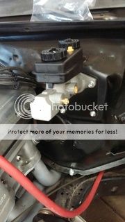

G-Body Manual Brake Installation with manualbrakes.com G-Body KIT
