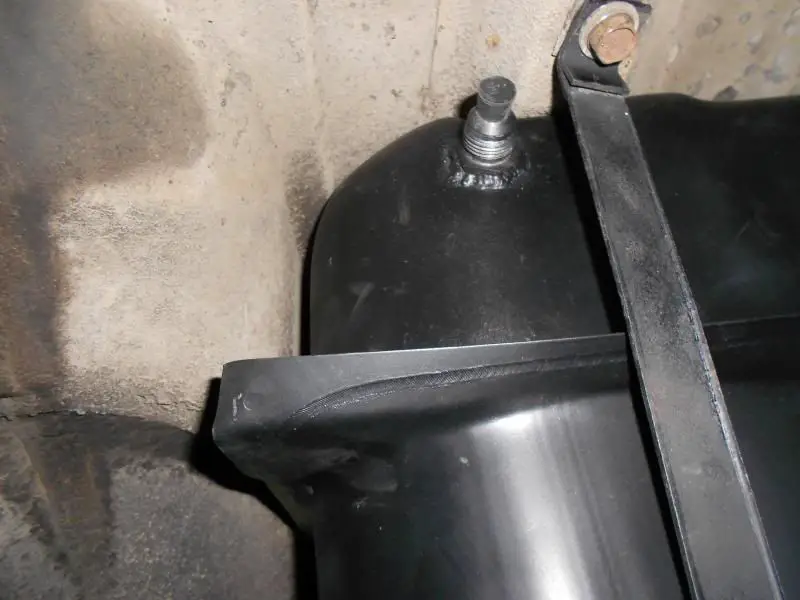

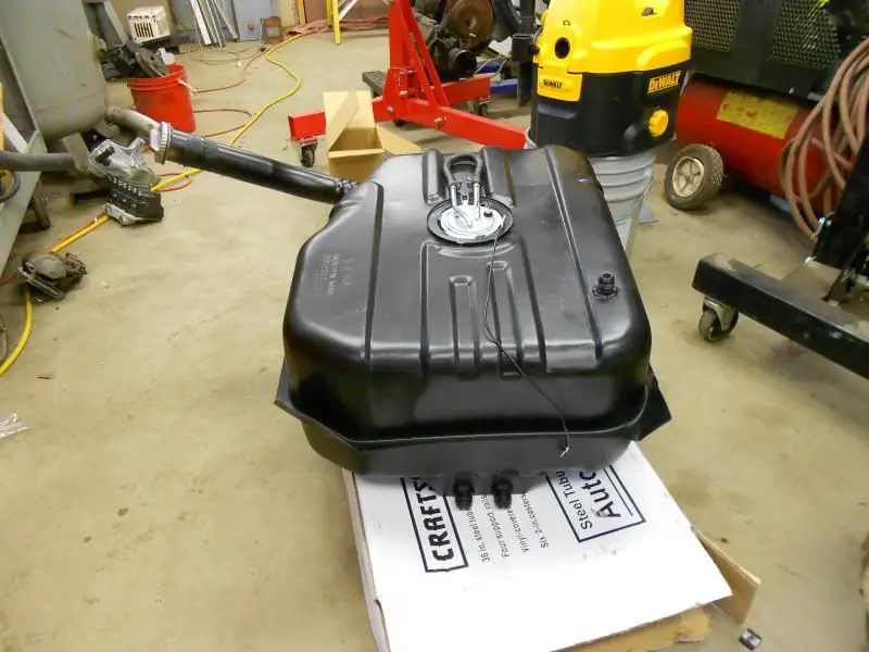

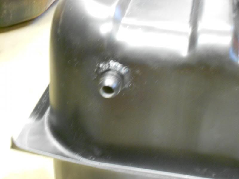

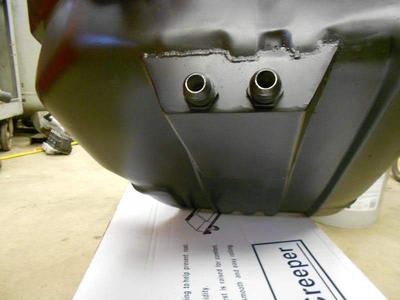

Here's the gas tank finished and ready to install, painted with a spray paint called "Iron Pro"..good stuff!!
-12an hookups
-10an return, I chose to put the return in the upmost corner rather than on top due to the lack of a "firewall" in the wagon. I am running the vent line on top as you'll see in another pic.
This is there the return line is situated when the tank is in the car.

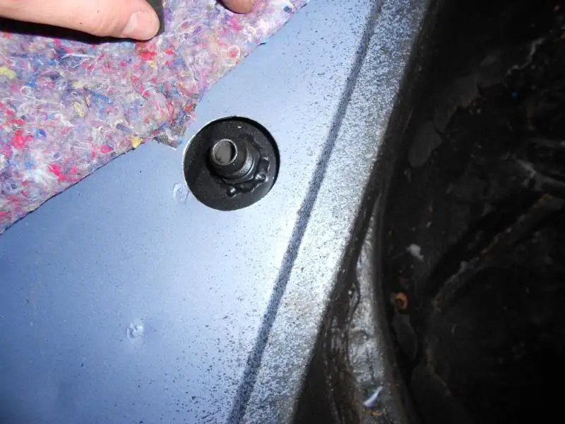

-10an Vent fitting/Check ball. I have a -10an 120* fitting with 2ft. of braided stainless I am going to use to route the vent line back through the floor and underneath the car. Not installed yet though. I know having fuel lines routed through the cabin of a car without a firewall isn't NHRA legal so I believe the vent system probably falls into that category but I'm more comfortable with a vent line in the car than a return line. However I may build a firewall for the vent line later.

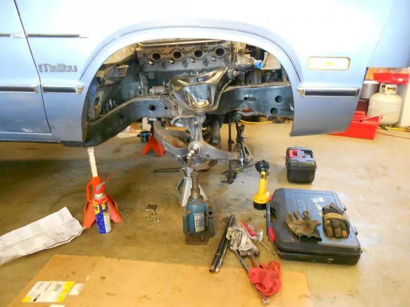

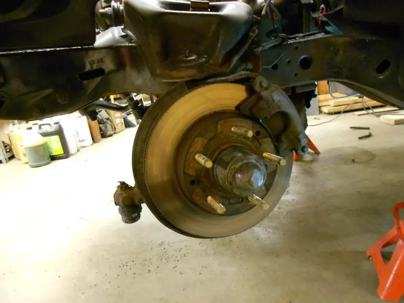

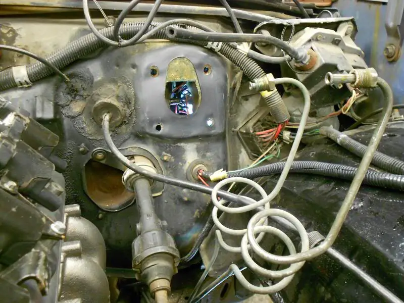

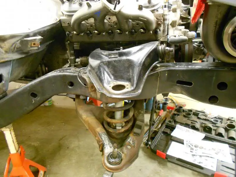

Out with the old!!

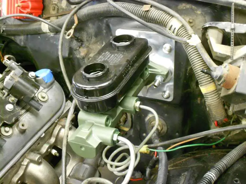

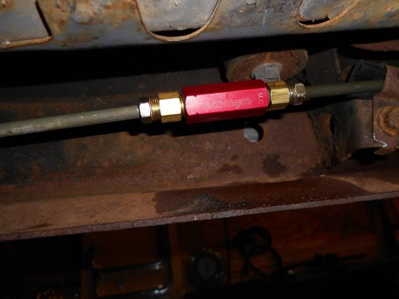

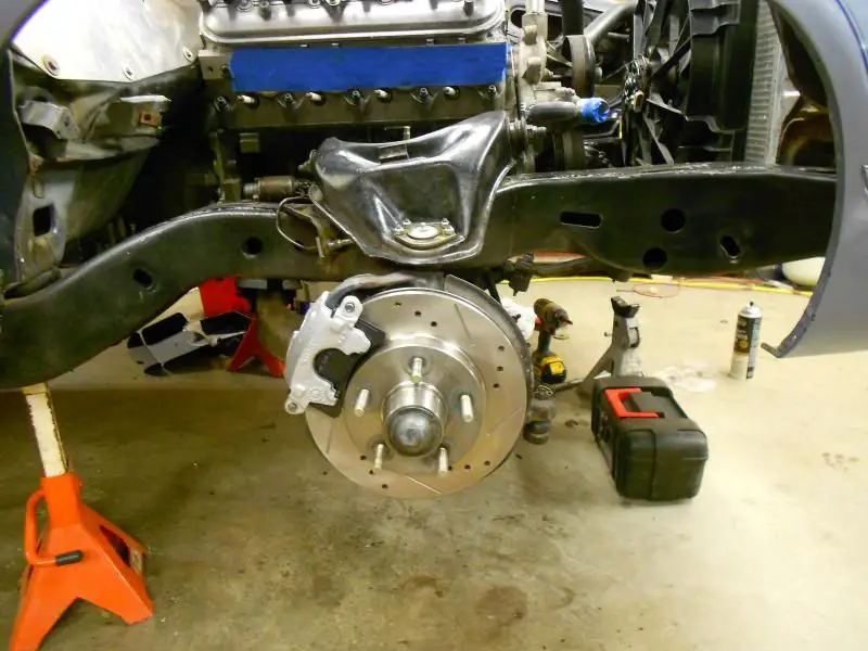

And in with the new!! New TRZ manual brake kit, stainless steel lines, Wilwood 10lb. residual valve, Powerstop drilled/slotted rotors and Z16 pads, new calipers as well.
