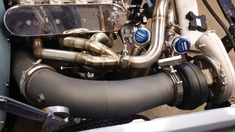

The guys from Fathouse did a great job with the turbo fab work. Routing the wastgates and a 5" downpipe past the firewall was not an easy task!

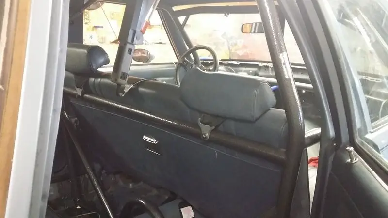

Fathouse also did the cage. 10 point 8.50 certified.

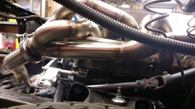

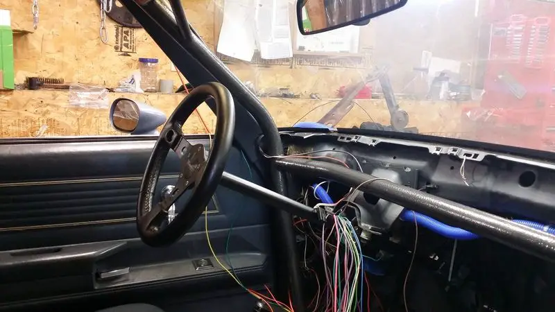

Close up of the driver's side header. I went to a TRZ tubular steering column with my S10 box. Nice stuff!
