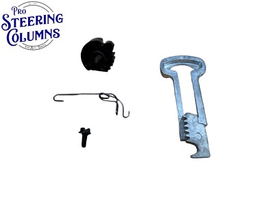

Rack: 7844651; only sold as part of a kit
Make sure the rack you buy has the same number of teeth as your original one.

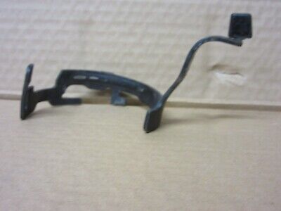

If you compare your lever to a good one, yours looks like it has a piece broken off where you press with your finger. There is a soft pad that pressed on in some cars, but not all. There is still a pad to press that you no longer have.

An NOS lever sold in February.
