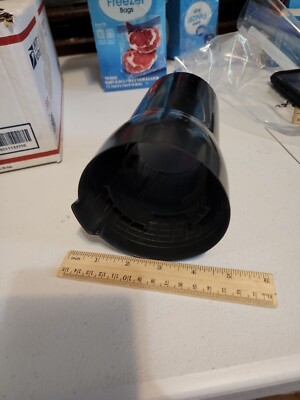

My brother just sent me this screenshot of a bowl he found. I really have to get with the neighbor that has my column and quit screwing around just don’t want to lose my temper lol

That is the part number I gave you for the 1986-1990 S10 (7846295).
If the 1986 S10 picture you get shows a good measurement, you can weigh the cost of the used column vs. the cost of new/used individual parts.
I measured the distance from the dash to the end of the shroud. You can compare this measurement to the 1986 S10 picture you get and see if it will work.
If it will work, start searching for that shroud part number and find the best deal.
