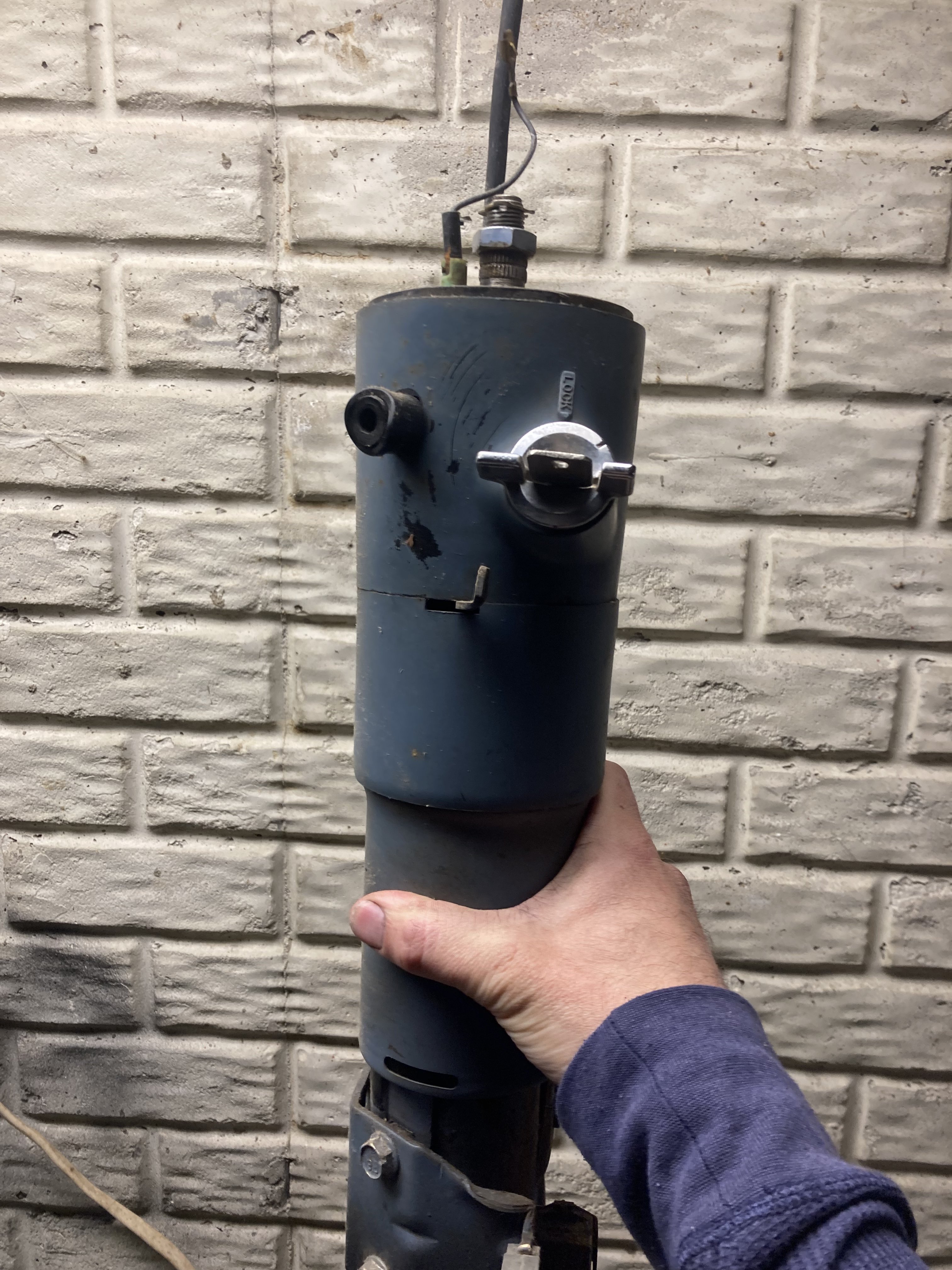

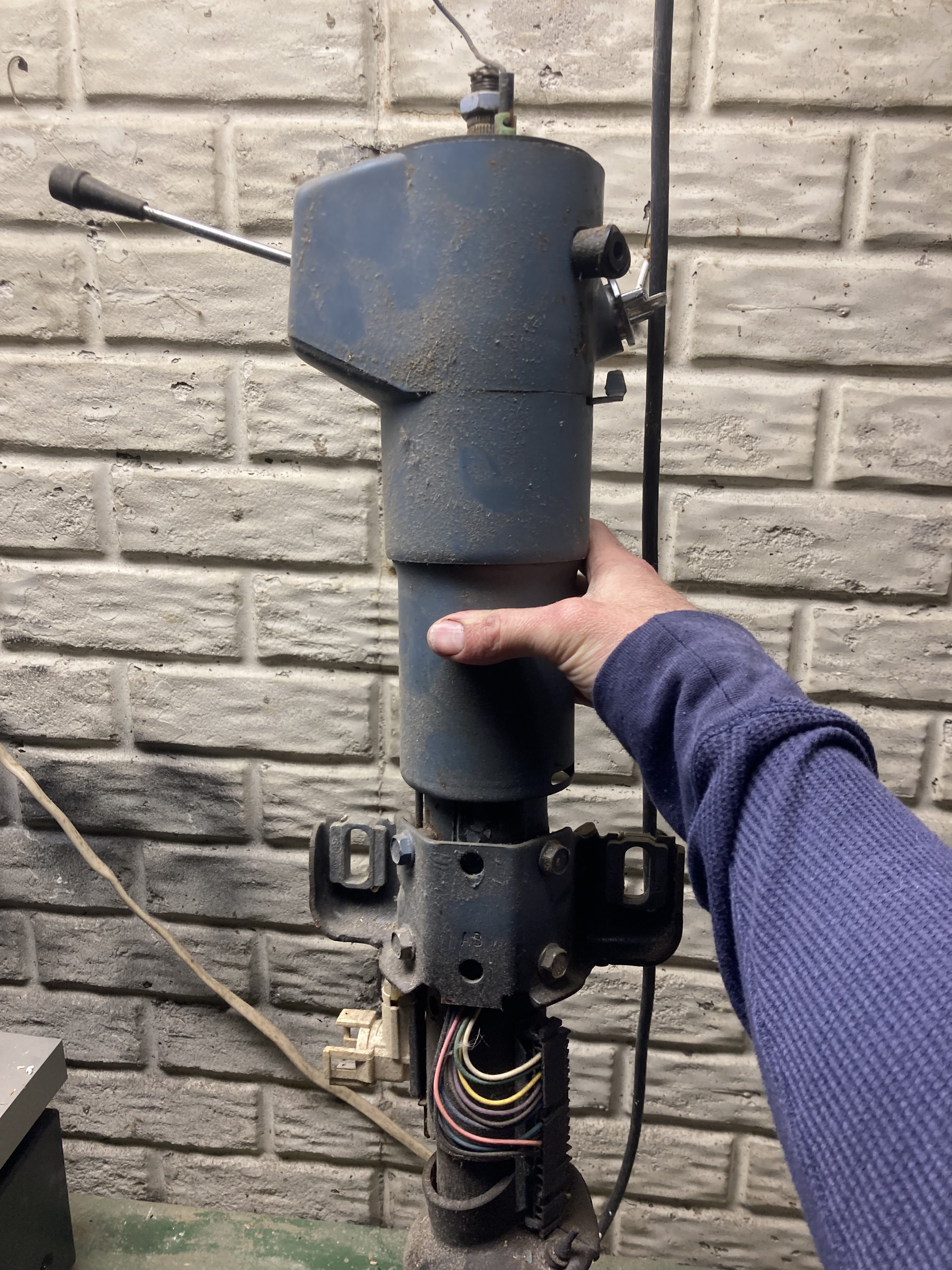

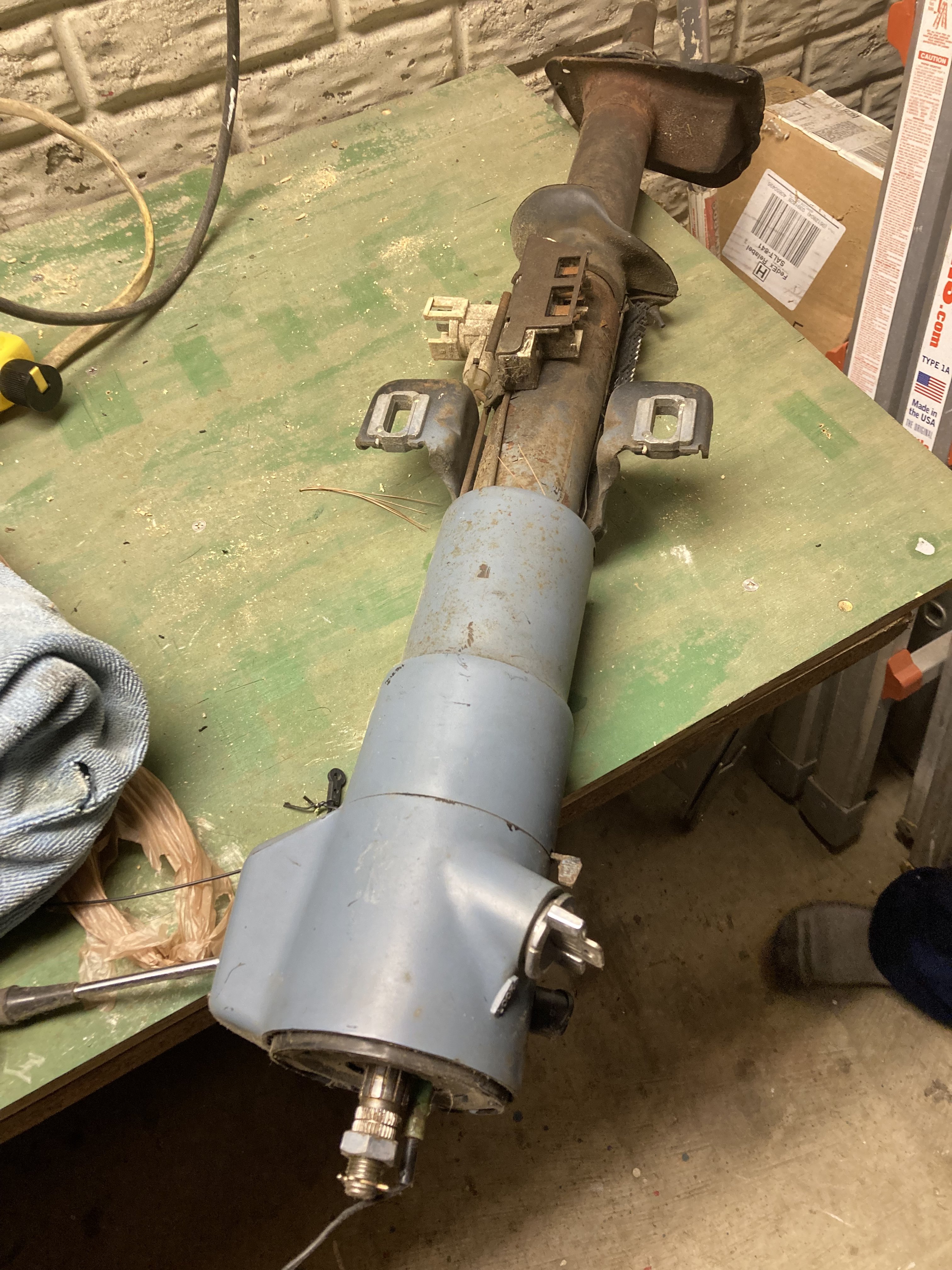

This is where I’m at now…. I realized I should’ve bought 3/8 braided fuel line instead of a pre bent metal line. Then my brother noticed that just about all of the body bushings were pretty chewed up so I figured since the trans is already out and the steering column is already out and I have the new fuel line, I’ll add another couple days to the project. I spent all evening after work last Thursday power washing and scrubbing the frame with degreaser. Then hit it as best as I could with a wire wheel. Luckily the frame wasn’t in terrible shape. I was going to buy some rustoleum paint but my brother said to hold off and he’ll pick up something from the industrial sherwin Williams store by his house. Hope he has that tonight so I can get painting. That fuel line came right out of there with the body off!! It wasn’t even in terrible shape. I received the new body bushings last Wednesday but it didn’t come with bolts so I ordered some from mikes Montes.com and received them as well. I’m hoping I can have the frame painted and the body set back on by the weekend.
