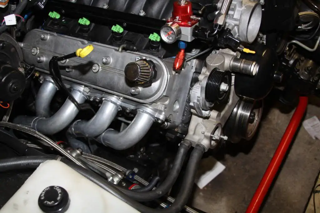

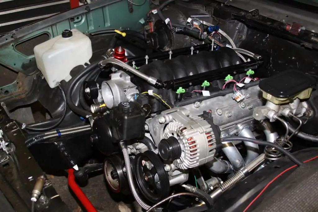

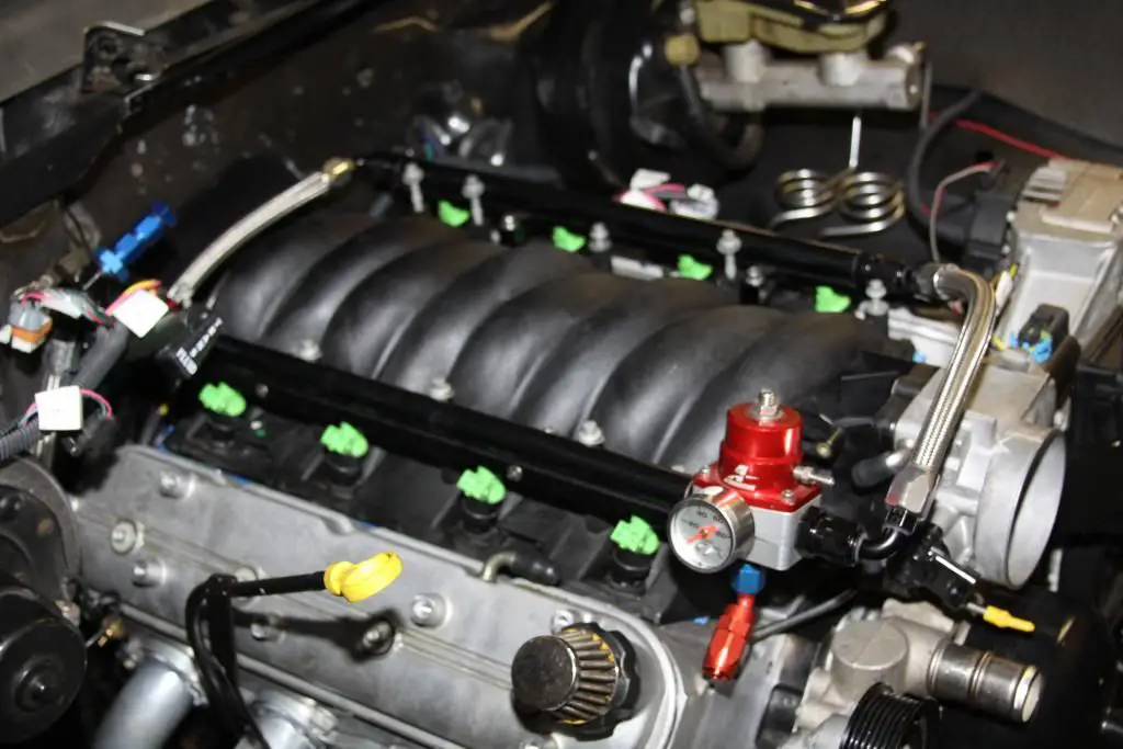

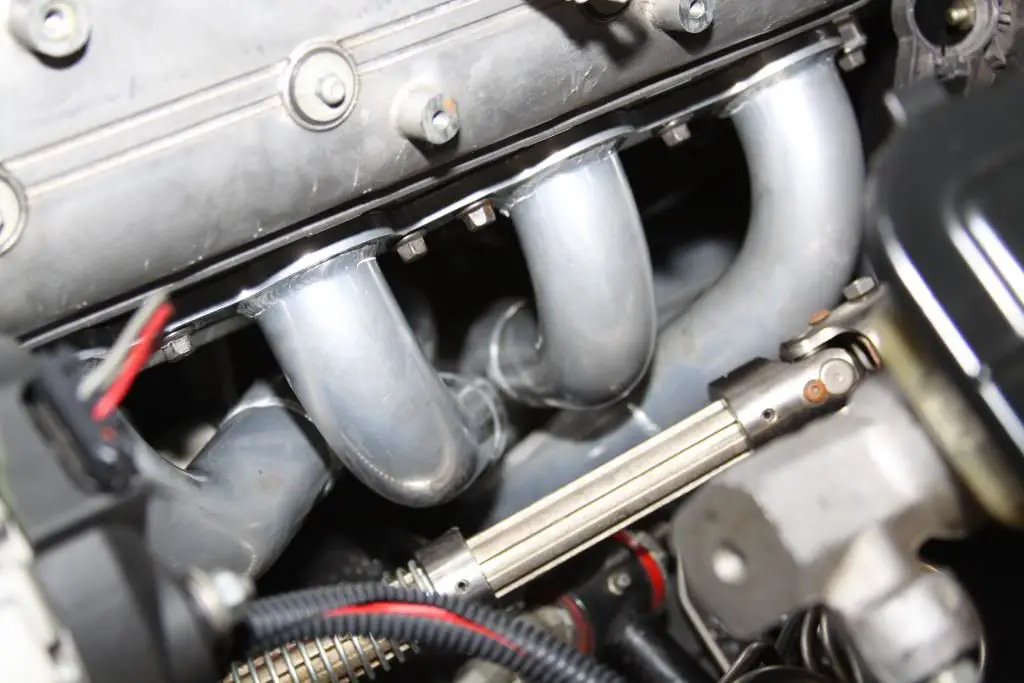

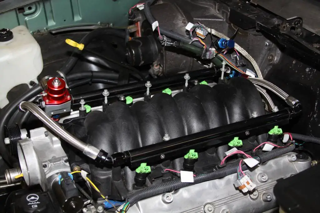

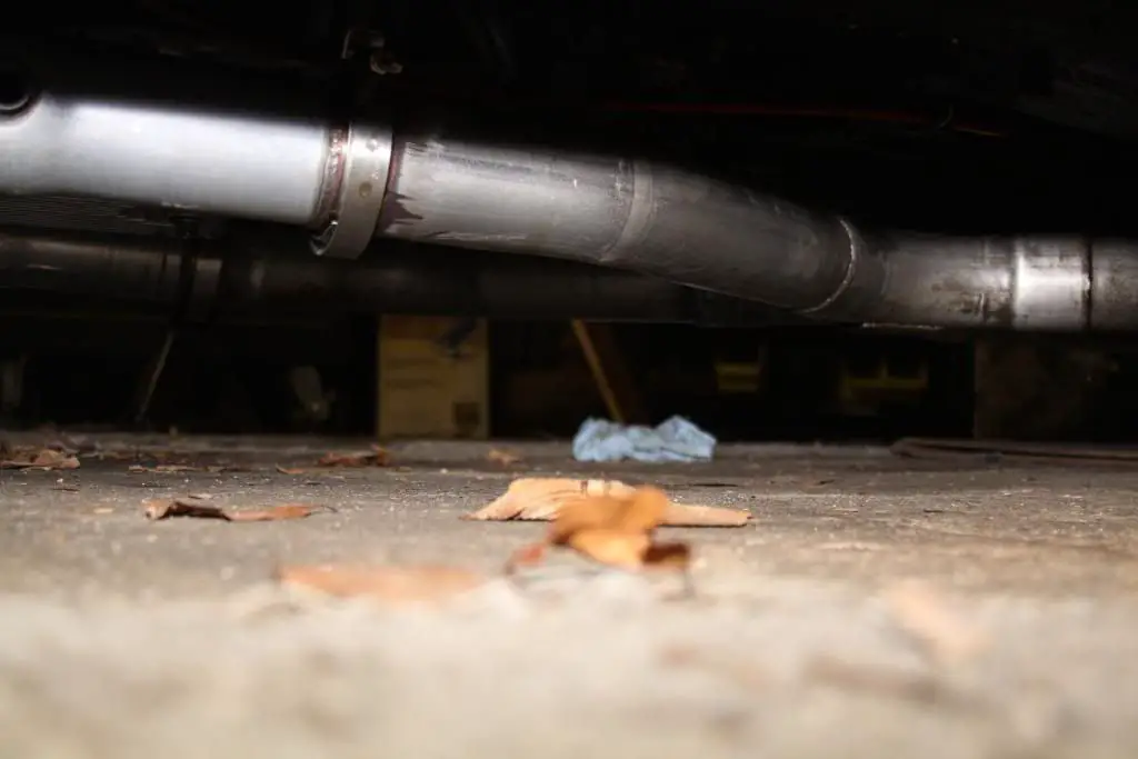

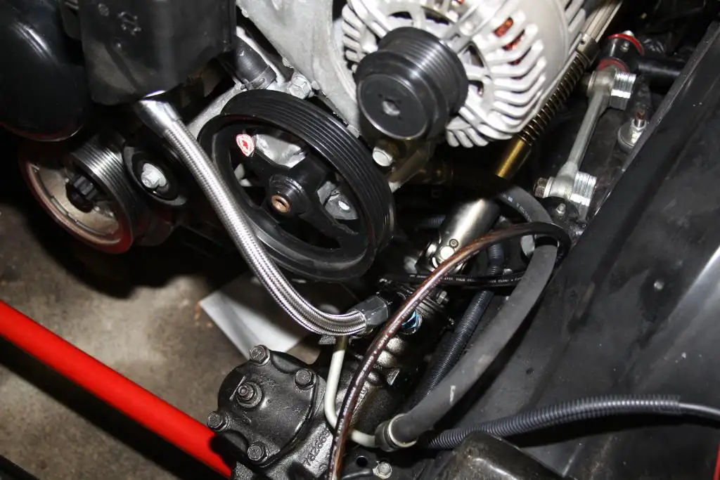

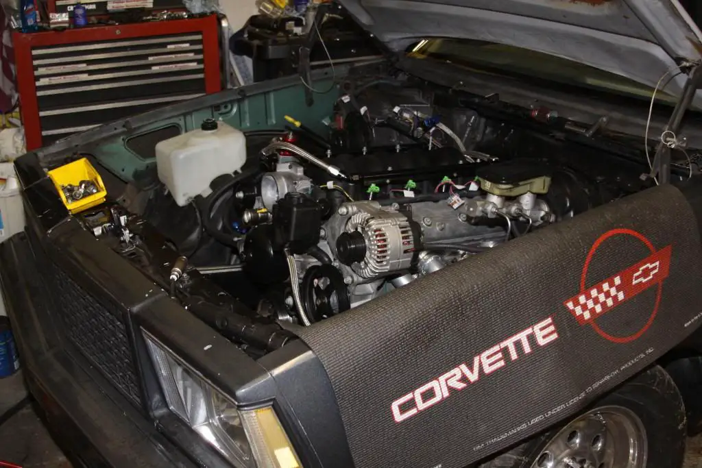

Monday Night progress. Motor is in car, headers are all bolted up, converter bolts, and alternator and power steering secure.
Tuesday night should get the radiator in car, pushrods in, intake bolted down, fuel rail and return pumbed, and starter bolted up. Then just some connector, oil, plugs, and gas for Weds. and its should be running.
Here are some Pictures

Re: NEW Project 1978 Malibu LQ9/4L65 Swap Updated 4-14-2011
I like the band clamps on the exhaust... makes for quick disconnecting of pipes....
