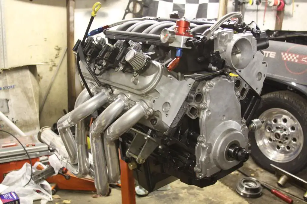

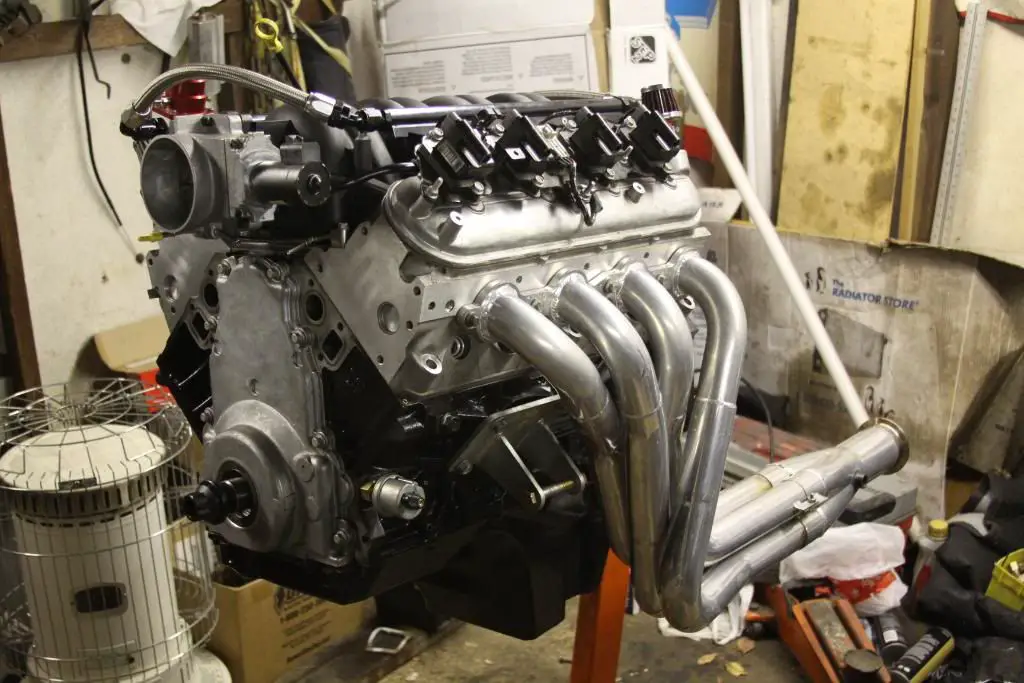

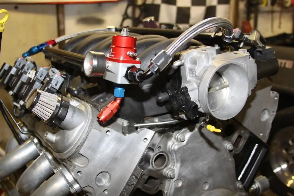

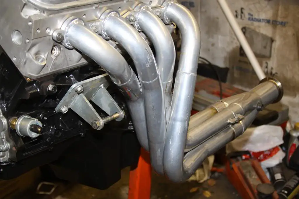

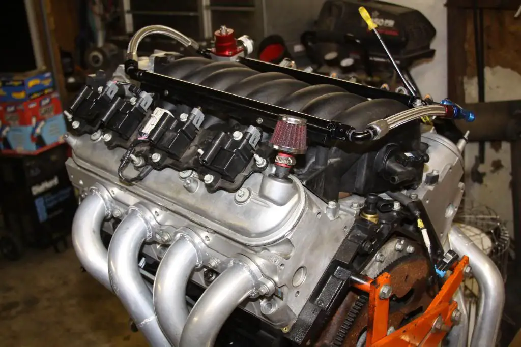

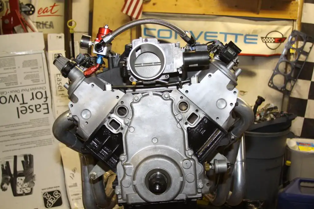

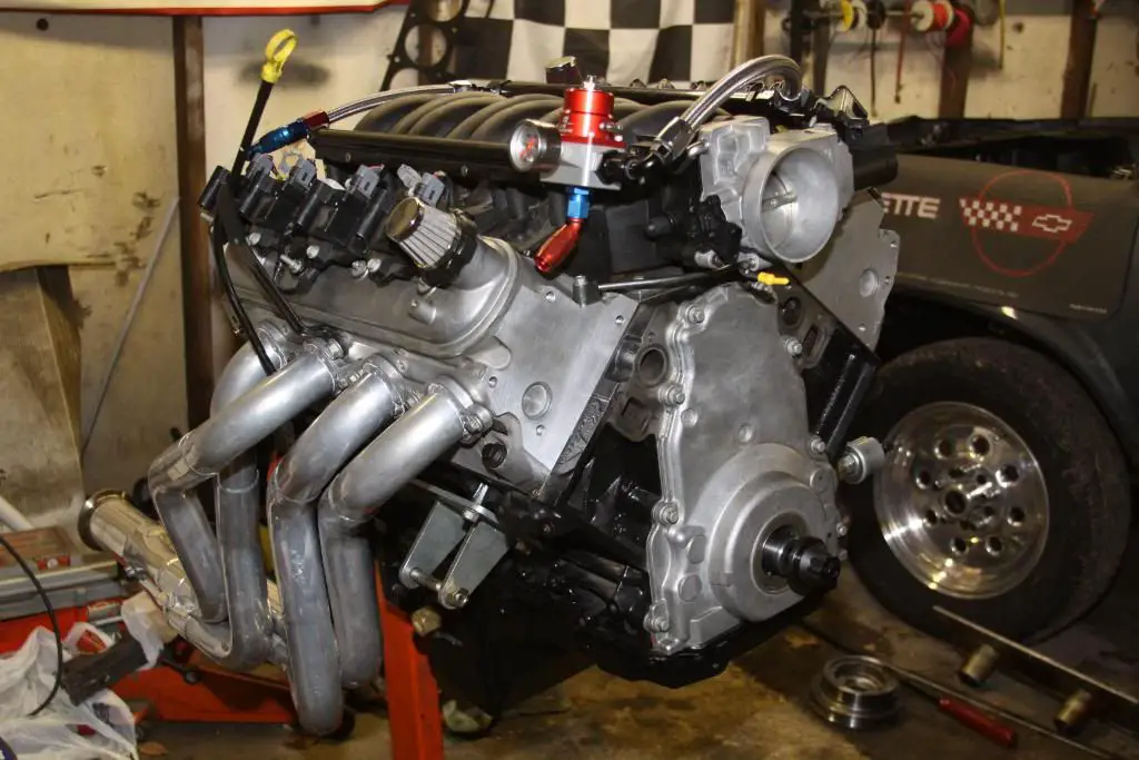

Re: NEW Project 1978 Malibu LQ9/4L65 Swap Updated 4-14-2011

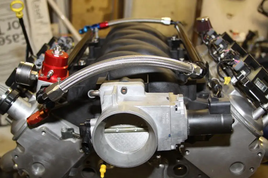

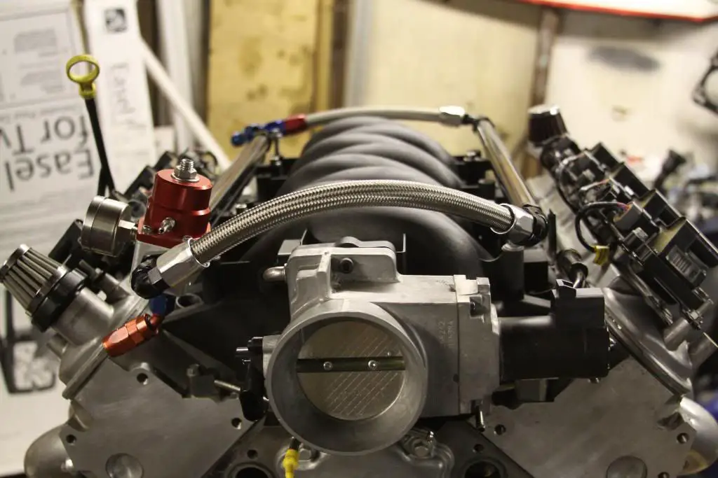

Nice 70 degree day gave me some time to get this thing stuck together. Mocked everything up and redesigned the fuel lines. needed to check some clearance.
Hopefully Sunday or next thrusday it will be dropped into car and get eveything hooked up.
Ralph

What a great Easter! 80 degrees Hot and muggy. Well if i didn't have to go out to the inlaws then we would of had the motor back in the car. Should be able to get it dropped in Monday Night, Headers, Converter, mounts, and starter should be completed, then just drop set of pushrods, bolt intake on and fill rad and oil then fire it up.
I will post the video when we start cranking her over, gonna smoke for a lil bit since all the oil in exhause from losing the motor last year.
