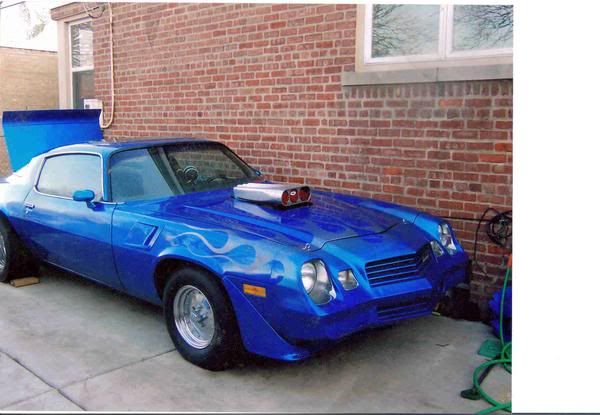

My buddy bought a 81 z28 quite a few years back. its a 383 (supposedly), 4 speed stick, posi rear end. It was maroon but has been painted a metallic blue with silver ghost flames (never painted underside of trunk but did do doorjams). It has a gear driven cam, and a tall air catcher with the 3 red butterflys coming out of the hood making it look and sound as if it has a supercharger.
any who the car has this weird shifter on it that only goes back and forth (not side to side like most common stick shifts) with a separate lever for reverse its a little bit complicated to even shift....He was asking my advice on it as he plans on putting a little bit of money into it (also when you shift your knuckles hit the dash kind of a crappy set up). My first thoughts were to get rid of the shifter and install a regular shifter with a bend in the handle to put the ball more comfortable in reach and to keep from smashing his shifting hand.
but here is the kicker I heard from another guy (more of an acquaintance) that his trans must be a Muncie M22 rock crusher because that trans has that type of shifter....I looked all over the internet/google and couldn't find any info on this type of shifter or truth to that fact can any one give me any insight??

here you can see the crappy location of the shifter vs dash.

Wow... That is close. I remember driving 4 speed second generation camaros and like LS6 Tommy said the stock shifters were close to the dash... but not that close. I would suggest that he get a nice short throw shifter to enjoy. Keep the ram rod for the man cave or sell it for quick cash.
