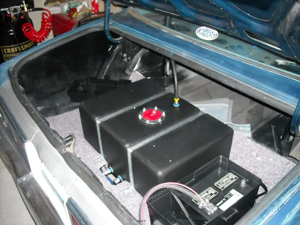

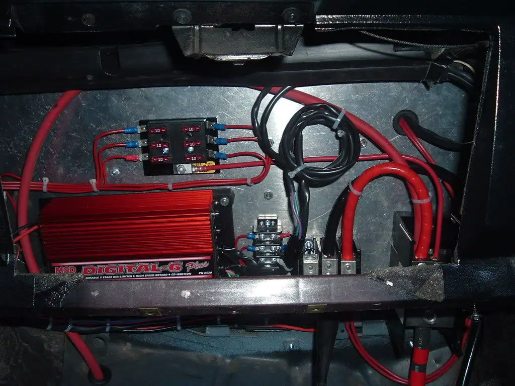

NEW2MALIBU
Mar 5, 2007
920
idaho
I ran 3/0 welding cable (overkill) from my battery to a distribution block behind the glove box. Grounded the battery to the frame in the rear of the car. One #2 awg ground from the alternator bracket to the frame. One braided ground cable from the head to the body. One #2 awg from a distribution block behind the glove box to the frame. I am a electrician for 25 years, can't have enough grounds, especially on DC. And if you are going to the track, I found out Sunday, you need to have a ground wire from the metal ring on the fuel cell to a grounding point.
